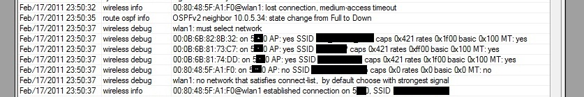

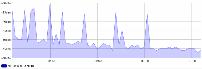

I’m having a big problem with a 10km radio link, two RB 411AH with r52n and wln200
Every few hours link drops for a while and restart. I don’t know why, i tried to update to 5rc9 but seems worse.
All the signals are good (near -75db), ccq about 90%, modulations stable to 58.5Mbps/58.5Mbps.
Hw-retries set to 15, and disconnect-timeout up to 10s.
In wireless log I can see: “lost connection, medium access timeout”
Here the configurations

Any ideas? Mikrotik staff?
Thanks.
