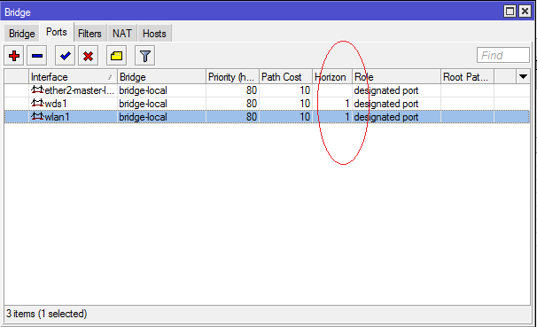

After trying several permutation of configurations, I managed to find a way to fix this. Under Bridge Port configuration, just enable Horizon settings on WDS and WLAN interface by defining a same number for both interfaces. Do note that this Horizon settings can only be enabled on one of the two WDS nodes else traffic will somehow not pass through.

I found this entry in the online manual. Evidently, data from one bridge port will not be forwarded to other bridge ports with the same “horizon” value.
Does this mean the problem is that data arriving on the wlan port (via the WDS interface) is being forwarded back out the WDS port (via the wlan interface), and vice-versa?
  • If so, should the wlan interface itself not be a port on the bridge, just the WDS interface (via the wds-default-bridge setting)?
  • If both are required, does this mean we have to just assign the same “horizon” values to each pair of wlan/WDS interfaces?
  • Must WDS be static in order to assign it a permanent horizon value?
Lots of questions, very few answers forthcoming without a tremendous amount of trial-and-error. I’ll be doing the latter today; hopefully someone else who has “been there, done that” can help me out with the former.
