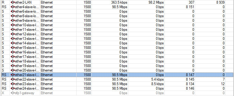

This screenshot shows me pushing a file over my gigabit network from a PC on ether2 to a server on ether8. You can see that both have negotiated at 1Gbps , what’s strange is the reported traffic on ether19 as the computer on that is on standby and there should be no traffic going to it.
My setup is pretty much as it is out of the box no queues and only a handful of NAT rules on the Gateway.
Apologies for bumping this a second time but i unplugged the cable from ether19 and the speed shot back up again. Its like the every port is only going as fast as the slowest link? When i did unplug ether19 winbox still reports its rate as 10mb even with it unplugged.

To clarify, the issue is being caused by the switch chip behaving as a hub… All traffic coming in any port is being forwarded out all other slaved ports (broadcasts or not). If you have even one 10Mbit link, all links must transmit at that speed.
Only affects hardware switched ports, not bridging ports. Not even a foggy idea how this could have happened.
