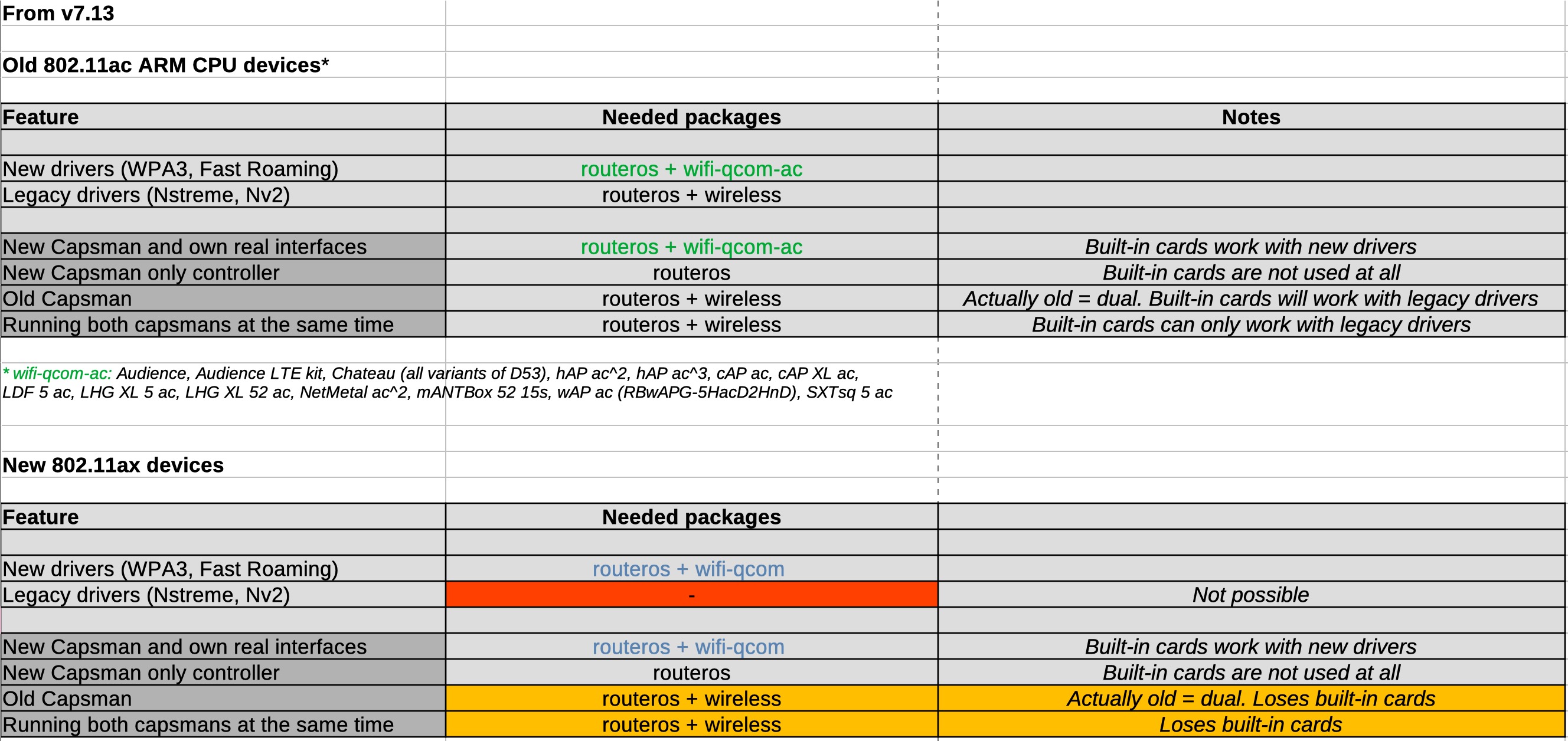

We made a table with some clarifications, can you guys let me know if this clears up some confusion? I see that Documentation and YouTube video still leaves some questions unanswered. So let’s try it like this:

at least for me this is fair enough
If any edge cases are missing in the table, let us know, and we will make the ULTIMATE guide for packages :slight_smile:
i think Youtube video does a good job clarifying most of the situation.

The unfortunate position of the RB4011iGS+5HacQ2HnD w.r.t. WiFi support could be clarified better.
Shame. From YT and press notes I was under impression that it will be possible to have wifiwave, legacy CAPsMAN and use onboard wifi interface :frowning:
Shame? On contrary, a respect for MikroTik. They did exactly the opposite of planned obsolescence.
MikroTik brought new software to old 802.11ac ARM devices. Now you can have 802.11r/k/v seamless fast roaming, with one WiFi/WifiWave2 CAPsMAN, without a need to replace wAP ac or else devices.
Same here … the Situation for the RB4011iGS+5HacQ2HnD is not 100% clear for me :wink:
br, Richard
Easy, like manual says RB4011iGS+5HacQ2HnD-IN (no support for the 2.4GHz interface). Installing the new driver will remove 2GHz, only 5GHz will work

Table is about specific products, it is said above each table. Products not in the table - not supported. Think about it that way. I don’t see RB133c either. What could it mean?
Perhaps the RB4011 deserves a footnote in the @normis table, given you lose 2.4Ghz with qcom-ac?
Similar with Audience, it needs a footnote too. e.g. it’s pitched as “meshable”, but that requires manual configuration with qcom-ac to wireless “mesh”.
