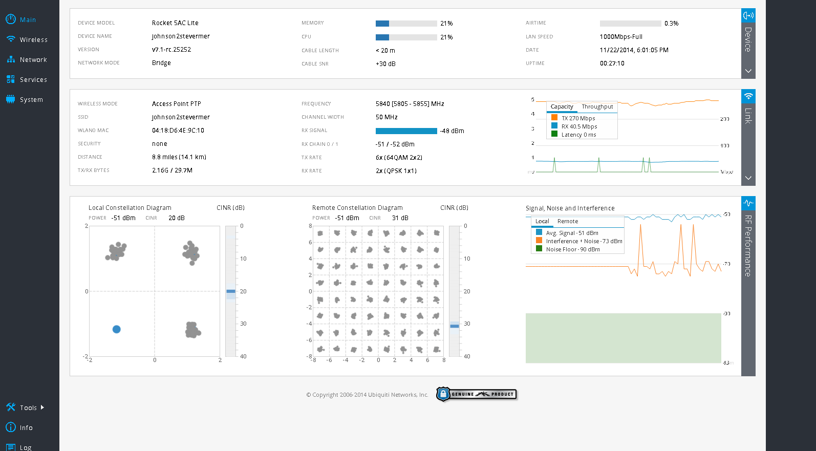

Just bought my first ubnt AC. It has a very cool live spectrum analyzer that works without taking service down. Mikrotik I want to use your product. Can you do this?
On this photo i like a lot the fields Airtime and Interference + Noise
Yeah very helpful in live network.
I always welcome any item which helps in wireless but there is missing data,
For example is interference + noise -73dbm is it for the frequency used or as i suspect it for 4.9 to 6GHz,
The 3 peaks on the picture what frequencies are they,
Also without putting the radio into listen mode which disconnects registered clients you cannot get an accurate spectrum scan.
I agree. But its something that does work in the field. I just installed 3 of them instead of more AF5. I am just looking forward to getting anything helpful from mikrotik. Right now we just can deploy with see blind.
I made a similar feature request about a month ago, about the “Constellation Diagram” coming to RouterOS. At this moment, on the radio side alone, my view is that Ubiquiti wins MT hands down. Custom, highly sensitive and channel-selective ICs and advanced metrics, at the time that Mikrotik still struggles with NV2 performance issues and 802.11ac support is poor (still with no spectral scan).
yeah I dont use NV2. Nstreme is so solid. Its better than any other protocol out there. As long as you know how to use it.
