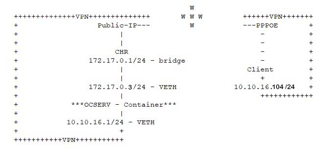

How should one configure the container network in Mikrotik?
Network diagram.

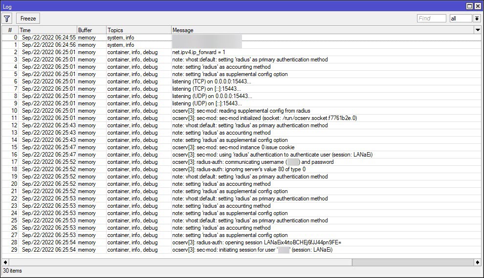

What is working?
I tried so many different versions and repositories. This build is not final. But before making more effort, I need to know if this will work.
Container
Radius
Ocserv
Connection

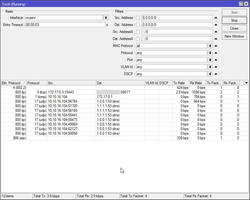

What is not working?
As far as I can tell :

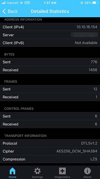

From the client side, I can ping
10.10.16.1,172.17.0.2
I can not ping
172.17.0.1, 1.1.1.1, and 8.8.8.8
The client traceroute doesn’t pass the 10.10.16.1 IP address.

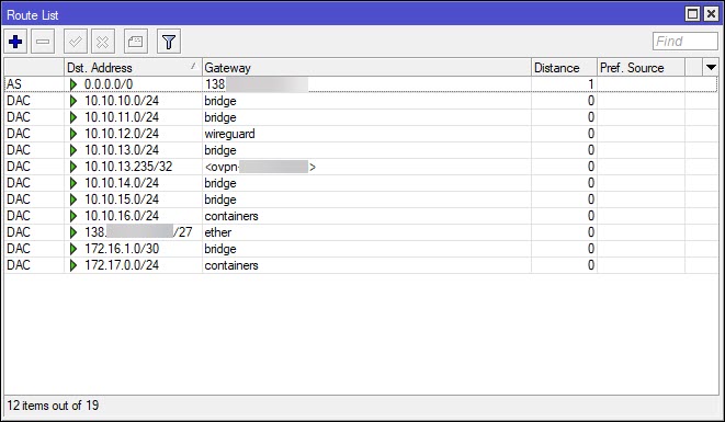

Here are some parts of the config.

I don’t think it’s correct to have veth interfaces parts of bridge and to set address directly to those interfaces. Additionally I don’t think you actually have to set address from subnet intended to be internal to container on veth of same container (to make this part work, veth should have proxy-arp enabled for the “internal” IP subnet).
I.e.
/interface veth
add address=172.17.0.3/24 gateway=172.17.0.1 name=ocserv
add bridge=containers interface=ocserv
# next part is IMO wrong. Address hould not be set on interface which is port member of a bridge
add address=10.10.16.1/24 interface=ocserv network=10.10.16.0
I think it should better work like this:
/interface veth
add dst-address=10.10.16.0/24 gateway=172.17.0.3
… the above relies on containers having correct default route set (internally that is) … which by default probably they don’t. Or do they?
I also think that you don’t need all those SRC NAT rules for traffic passing containers, in principle containers should manage with their default route set to router’s IP address from container network. Excessive SRC NAT may make things work when routing is not done right, but it also hides real remote IP addresses from service running behind such NAT. Which most of times is undesirable effect.
