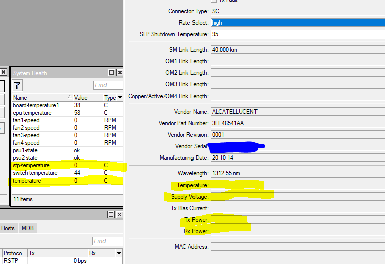

Seems like I was incorrect, the issue still isn’t resolved. System health shows the PSUs as fine, but nothing for SFP or temperature – even though I have a connection. In addition, TX and RX power are empty. You can see attached screenshot.
