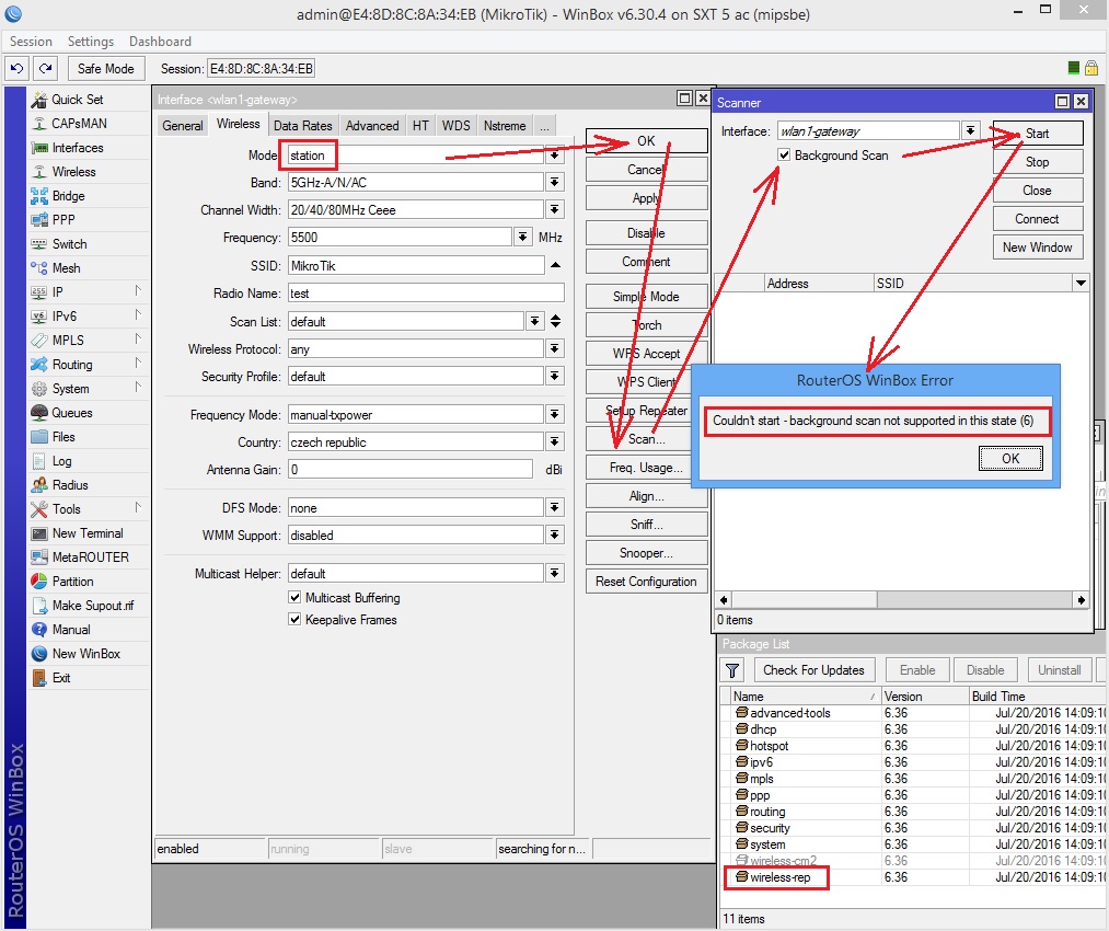

Thanks, but wrong answer. Unfortunately, it works only in AP bridge mode, doesn´t work in any station mode. Answer does not cover described problem!
I have of course installed last stable version 6.36 of wireless-rep package. Please try it self…

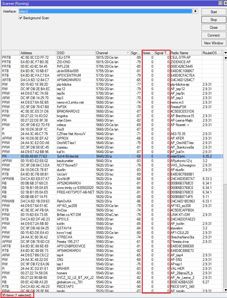

Only for illustration, typical situations to solve for ISPs in cities in 5GHz band ! Over 80 interferred other visible AP-s !!! There is visible only part of all 80 interferred AP-s ! WIthout this function is WiFi managemnt very difficult! Shooting frequencies like blind man ! :frowning:

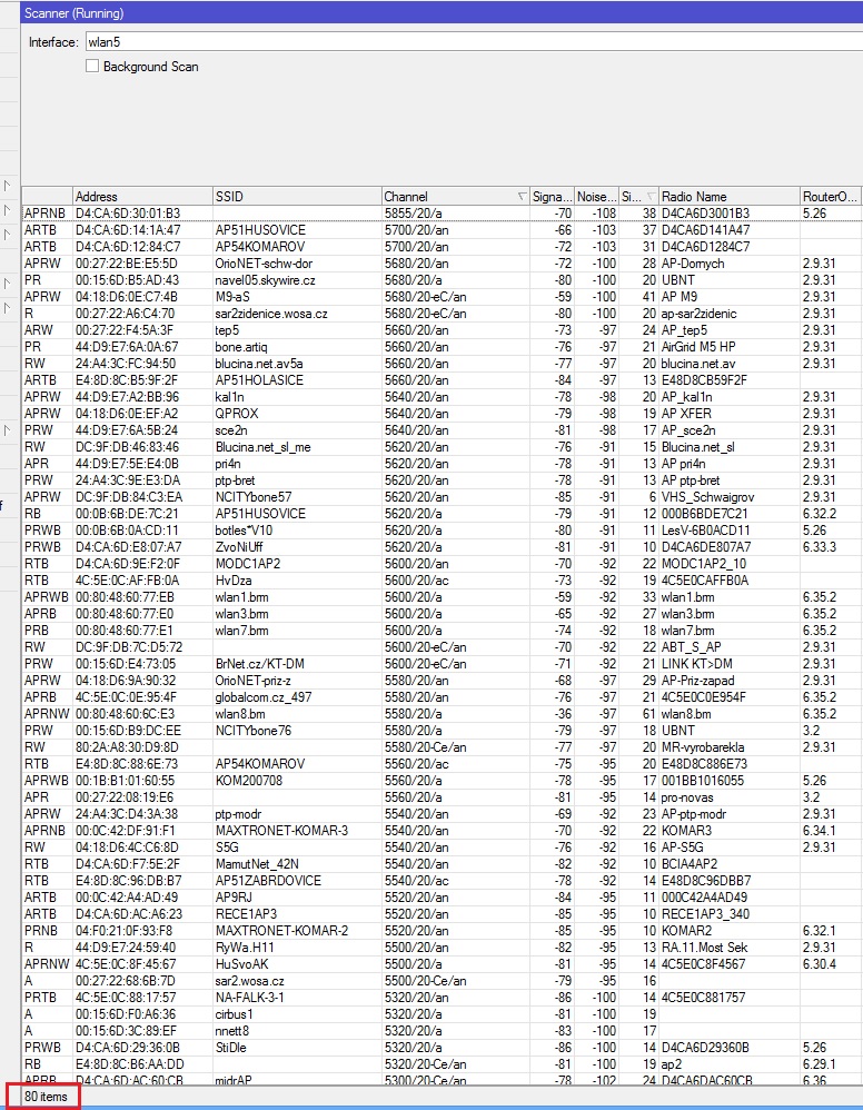

BTW: From the picture above can see Mikrotik business staff, how much percentage of other AP-s sold concurrency Ubiquity networks, with OS version 2.9.31 of their OS, that supports background scan both in AP and station. Those Mikrotiks with name wlanx.bm and Mikrotik OS ver. 6.35.2 are mine. UBNT Nanostations are not routers, but ISP prefer it because is not blind when configuring his network… Lost business for more clever Mikrotik OS without background scan. They are unable to provide such basic tool to stations for years ! :frowning:

Station mode can use background scan, but it needs to be connected somewhere. Otherwise, why do you need to scan in background, if wireless interface is not used?
Check the manual: http://wiki.mikrotik.com/wiki/Manual:Interface/Wireless#Scan
Client is connected run scan it is working :wink:
normis: SUCCESS !!! Your answer is ESSENTIAL CORE INFORMATION and this condition of CONNECTED CLIENT is NOT MENTIONED IN MANUAL at http://wiki.mikrotik.com/wiki/Manual:Interface/Wireless#Scan !!! Logically everybody try it first at new Mikrotik device, picked up right from post box, instead of experimenting at more years running Mikrotik´s, at live networks, that runs protocol n-streme, risking disconnection of clients!

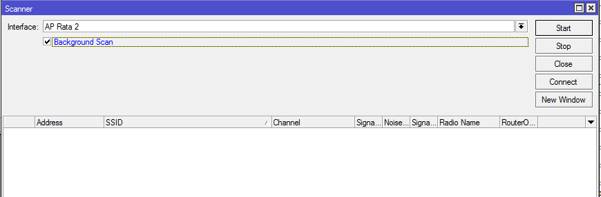

Now it works in 802.11 mode, only noise floor and S/N ratio is not displayed… but better then nothing… it is step forward. But: When it will work in n-streme station mode?
And now I am gonna to try similar function: “Freq, usage” this should display interference covering of channels not only by AP´s , but also clients working in band? … But there is not this option to scan in background… :frowning: Then it is obsolete function on staions).
At the picture you can see in percentage, how much of market your company lost in my town only by NOT MAKING THIS SCAN FUNCTIONS CLEAR AND EASY USABLE… see picture and OS versions ! Those 2.9.31 are yours competitor Ubiquiti products… :wink:
Thanks for your effort, but add the core infos to manual or better into Error message, that appears after unsuccessfull attempt to run it ! All the Ubiquiti AP´s bind about >10-times more clients from same manufacturer… and this is outlook only thru angle 8° by one 26 dBi antenna in one polarization ! 96 AP´s! :wink:
