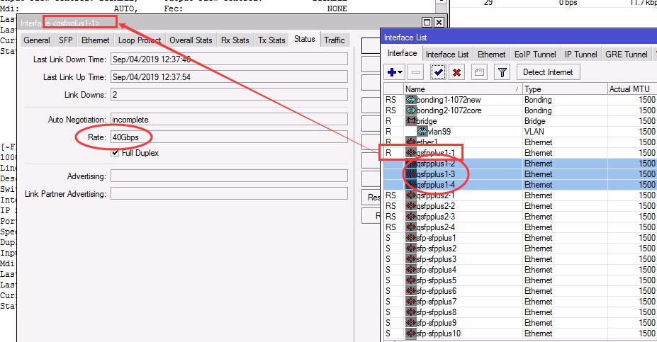

you should disable HW switch “negotiation”,enable CRS326 auto negotiation.
then the 40G port is up!
In CRS , It will show qsfp1 up (2,3,4 down), but you can see the qsfp1 port speed is 40G.
