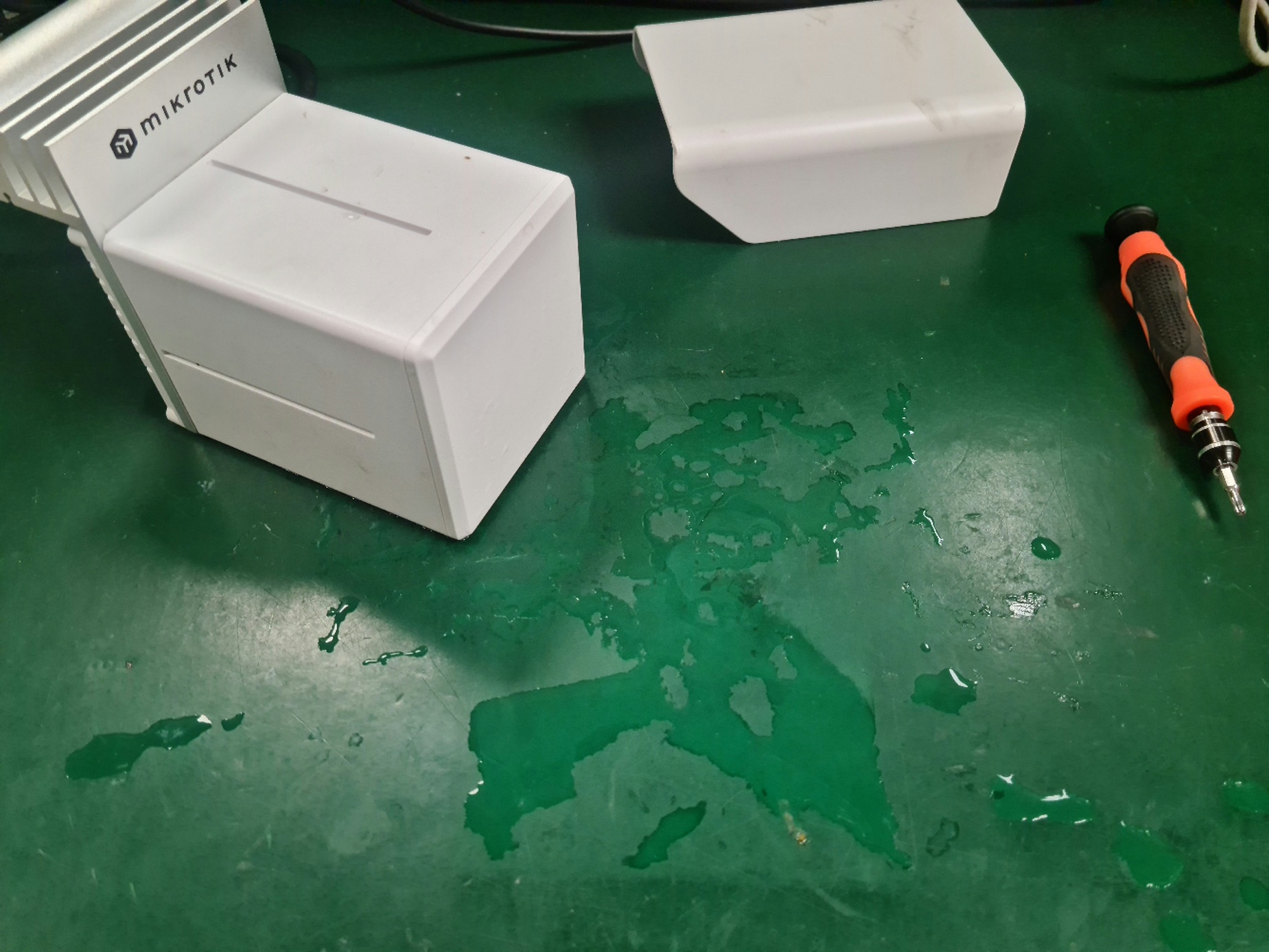

It has happened… the curious thing is that it was not pointed downwards, rather with an angle of 45 upwards. this worries me for all installed products.
Is it dead? I’ve seen people are using tape to avoid this happen…but how long will the tape last? Take good design (cube 60 AC and wap) and make it wrong (cube pro, SA)
Ye. We’ve lost a bunch due to rain as well. 90’ is fine but pointing up in hard rain. They’re toast

it is dead and replaced by another one… I understand that you will suffer the same problem

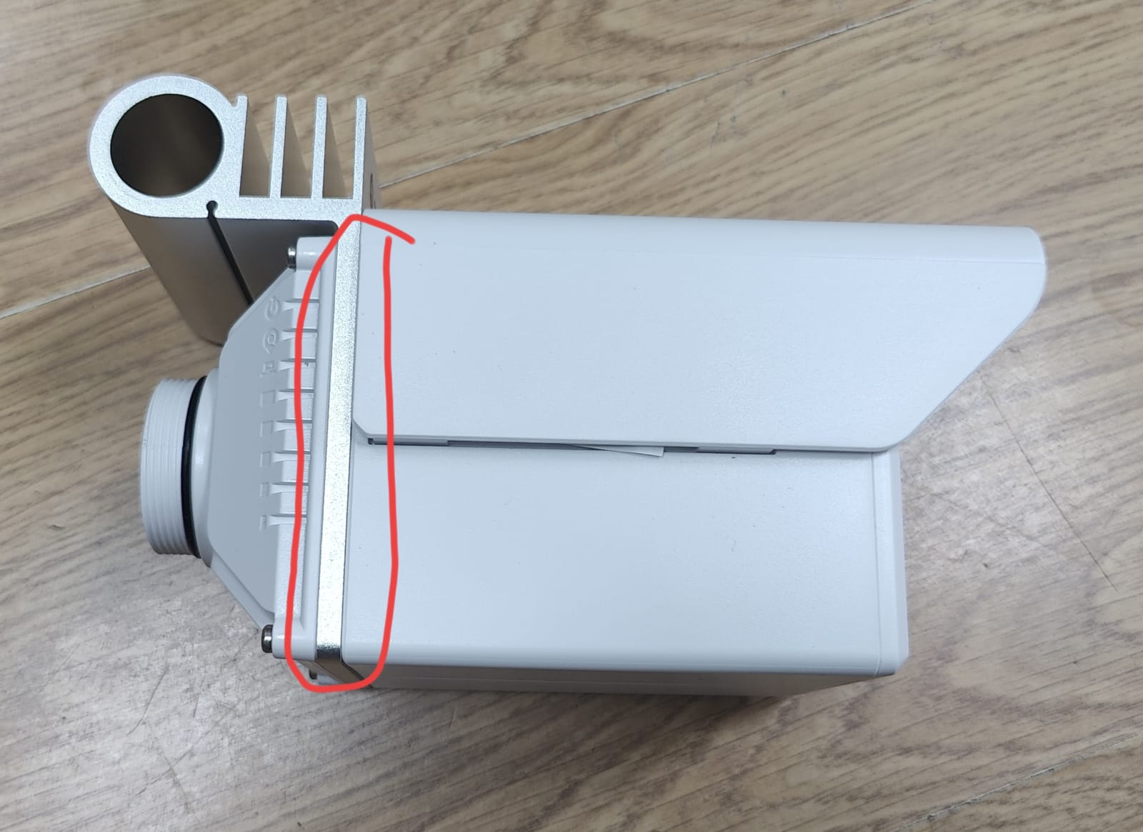

Yes, we also have water problems. Both CubePRO and CubeSA have problems. Unfortunately, it does not flow there through a grommet, but through poor-quality gluing.
Since the antennas have no drain, water accumulates inside. Bad design! :open_mouth:
Previous versions (WAP60) were better in terms of rain resistance
