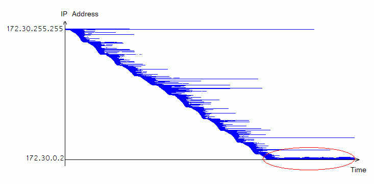

can anybody check current (v5) implementation against such behaviour?..
Yes I am currently using v5.5 and the reversing is still there !
Chupaka ask about behavior after reaching lowest IP from pool. Not about first allocation.
