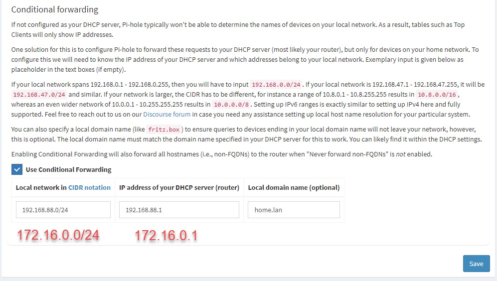

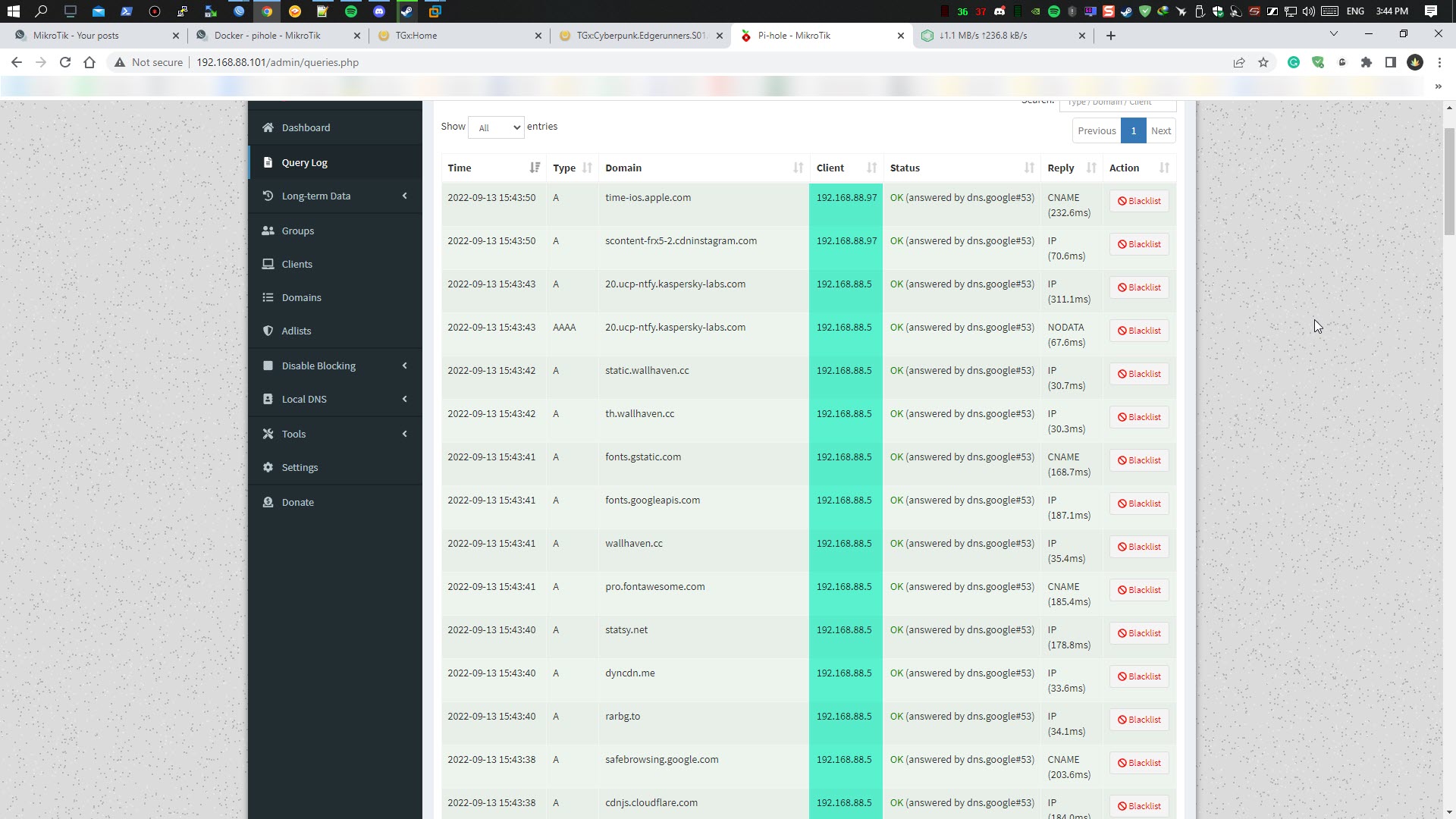

I have another question. What needs to be done so that all hosts are visible in PiHole, e.g. phones, computers (their IP addresses), at the moment when logging in to PiHole I see only one “user” - the local address of Mikrotik. I would like to add that everything was done according to the Mikrotik manual.
but if it will be working if I did all based on Mikrotik tutorial and I have different subnet than my MT? E.X - MT 172.16.0.1, PiHole 172.17.02?
As far as I know, it should. I used a container at MT for pi-hole.
You should know what is in MT documents is an example. That is not a complete walkthrough on how to use pi-hole.
The address should be the CIDR of your DHCP server. if you have 172.16.0.0/24 at your MT then it should be that.
So in my case what I should write in PiHole console? My MT address/gateway or PiHole? BTW - maybe You can write some additional tips complementary MT manual? :slight_smile:
  • additional tips complementary MT manual
https://docs.pi-hole.net/
  • set your DNS server at your DHCP server to 172.17.0.2 and also inside your pi-hole go to setting and in the first tab, you should see the same setting as screenshot blow.
Hi, sorry, but I did all as You wrote and it not working. Maybe You have any more idea what I should do? Thx.

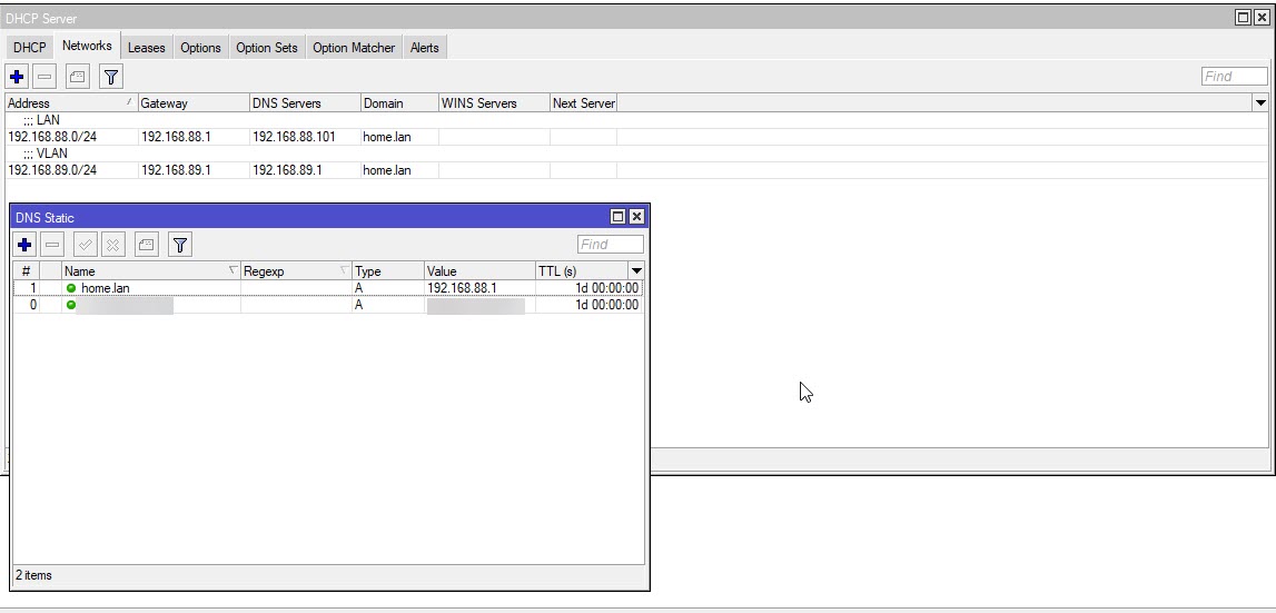

To start using Pihole
Go to ip DHCP server
networks
Double click on your
and change DNS server to.. what you use for pihole
after off on wifi and off on lan.. its should start using pihole

why masquerade is for address 192.168.1.0/24? And did You see all of Client IP’s in PiHole site?
Im not sure what you mean by… do i can see ip clients in PiHole
All devices “react” and work with that Pihole if that what you are asking for
