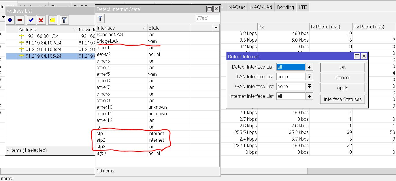

Does anyone have an idea how Mikrotik detect Internet judge WAN or LAN, please?

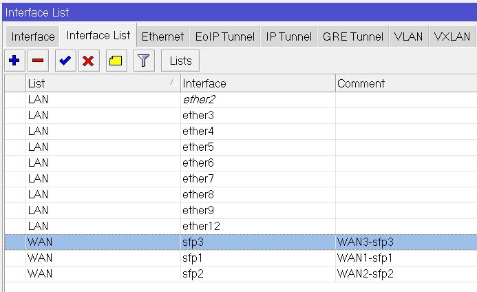

My sfp1, sfp2, sfp3 are my WAN1, WAN2, WAN3 but sfp3 being detected as LAN…
Here are the rules that are used for detection: https://help.mikrotik.com/docs/display/ROS/Detect+Internet
Yes, it is used to automatically populate interface lists. For example if you accidentally plug in a cable with internet access, you might open up your router to unrestricted access from the internet. This can prevent it, if it detects, that the newly active interface has internet access, your firewall rulrs will automatically protect it.
I read that document, but it didn’t tell how it judge LAN or WAN, only said interfaces can reach cloud.mikrotik.com using UDP protocol port 30000 can obtain “Internet status”. (My sfp1 & sfp2 marked as Internet correctly)
My sfp3 set up as WAN3 being detected as LAN, and BridgeLAN and Ether5 being detected as WAN, while they are all LAN.
Apparently RouterOS was able to reach internet though those interefaces. Maybe your bridge setup is incorrect or something else is wrong
I have my trust in RouterOS, therefore i am looking my settings for mistakes. It would be better for me to find them if i can know under what circumstance the interface will be judged as LAN or WAN. (I already know when will be judged as Internet according to your share knowledge base)
My bridge setup is simple, just put together all LAN ethernet ports. Ether4 & Ether5 are on a PowerEdge Server running windows server.
sfp3 is a WAN and capable of accessing Internet, even not, at least a WAN, but judged as a LAN.
As @normis said: this function is intended to detect (and autoconfigure to certain extent) WAN-facing interfaces (which is a very good thing). However, the experience is that detection success rate is lower than we would all love to see and when it fails, then the whole router starts to behave in random unexpected ways. Which means that if the router is administered at least half decently (which includes some thought when plugging in any data cable), its mostly better to disable the feature … Specially so as it relies on setup which closely resembles (or builds on) default setup. If somebody tears it apart, then leaving detect-internet enabled doesn’t make any sense what so ever.

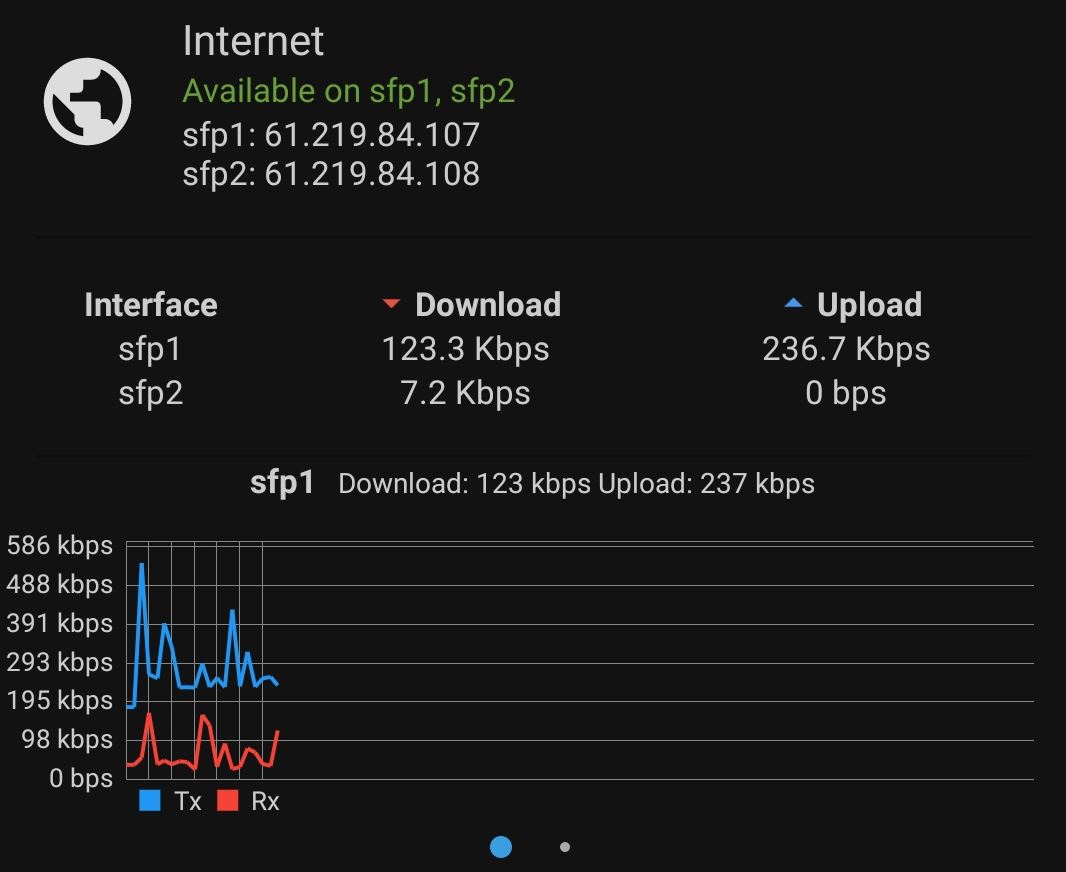

The detection results apparently also applied to Quickset, i am troubleshooting why when i added sfp3 (WAN3), then my LAN (use default 192.168.88.1) will be replaced by the new WAN3 IP. It offers a very good insight since it also list every interfaces attribute (WAN or LAN).
Especially the bandwidth usage diagram on Android phone are rather pretty and useful, i can’t resist to try to make it work.
Most likely your setup is too customized for this feature to be useful to you. Just disable internet detection and put the interfaces where you need them. Manually.
RoS feature I would quietly retire.
