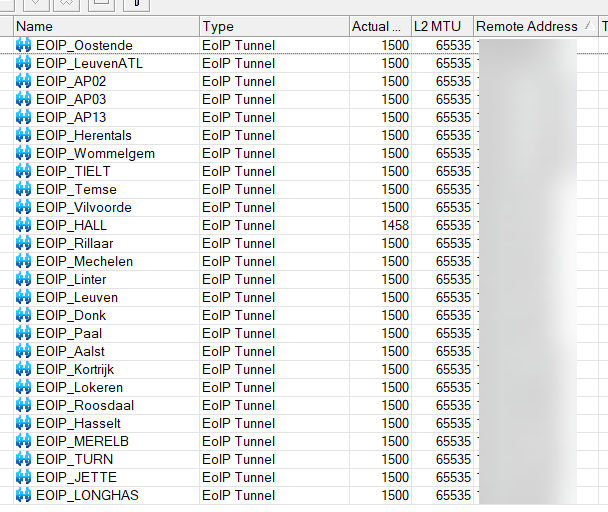

It’s not a problem to create new EoIP interface on remote routers but on main router I have only one IP on wireguard interface so i can’t use it anymore. How did you manage that ?
Same as with any other IP.
Same WG IP address for the other EOIP tunnel.
Only make sure to use another unique identifier to identify the other tunnel.
(tip: starting from internal IP address of the “remote site” I use value of 3th octet x 256 + value of 4th octet as key, this is unique across the complete setup of my customer)
See screenshot.
First 2 are via Wireguard. All the rest is via MPLS, all those remote devices are terminating on the same IP address of that RB5009.
