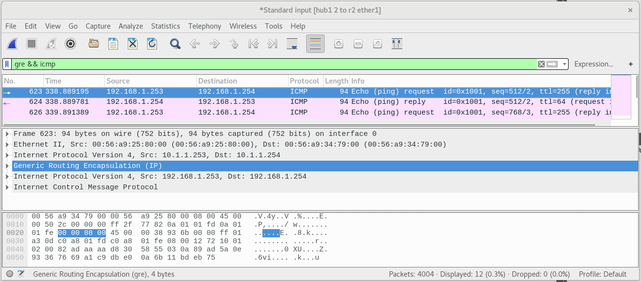

MikroTik GRE MTU
Looking at the above packet we see the anatomy of how it was built. We see the Ethernet header outside of all of our layer 3+ headers. We see the outside IPv4 header (20 bytes), a GRE header without any keys or sequencing (4 bytes), another IPv4 header (20 bytes) representing the inside IPv4 information and lastly the data which in this case is an ICMP packet. So in total we add 4 + 20 which equals 24. The largest we can set MTU for this connection if we have a base layer 3 MTU of 1500 is 1474. We don’t count the outermost IPv4 header.

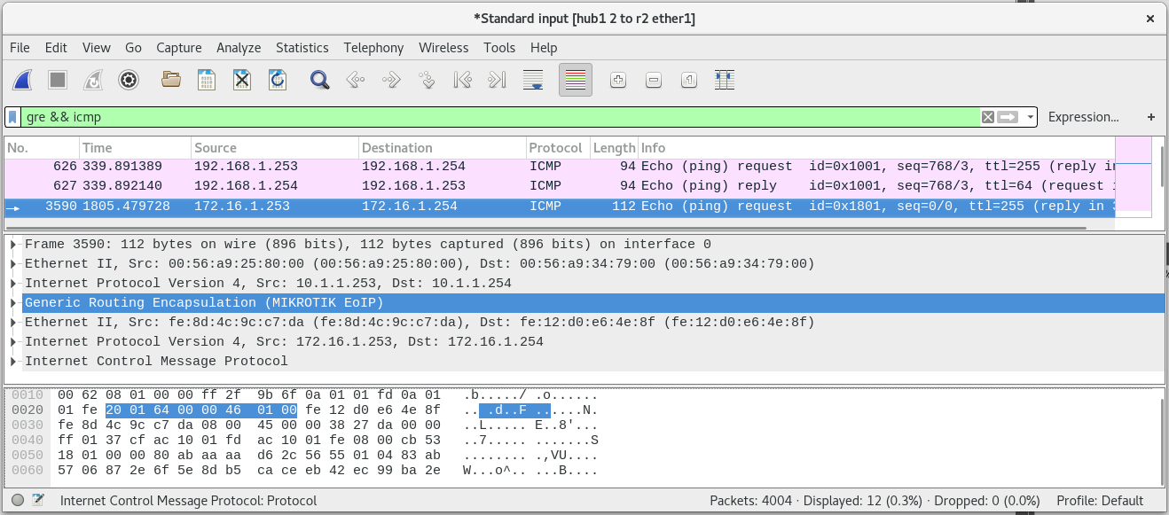

MikroTik EoIP MTU
You’ll see that this packet looks very similar. The exception is that an Ethernet header is squashed in between the GRE and inside IPv4 header adding an additional 14 bytes of overhead. This time the calculation is 4 + 14 + 20 which equals 38. The largest we can set MTU for this connection if we have a base layer 3 MTU of 1500 is 1462.
