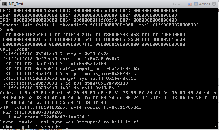

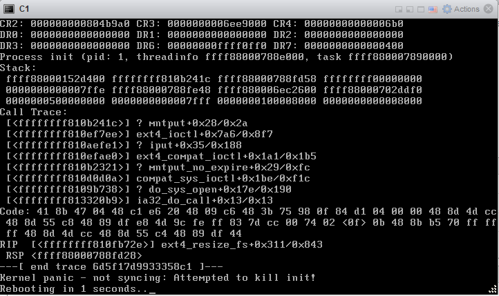

I installed Mikrotik CHR from ova file downloaded from Mikrotik’s website.
It seems to run perfectly fine until I want to change the disk size.
From the console it says ‘resizing disk’ and then I get the attached image as an error in a continuous boot loop - any ideas?

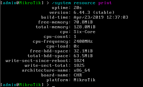

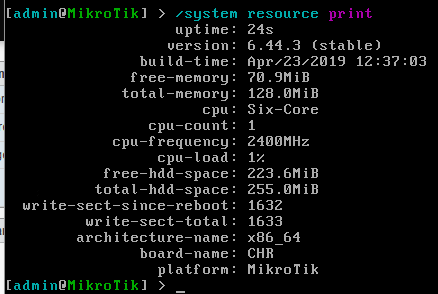

I can confirm that I have reproduced this problem within the limitations outlined which says it actually has a minimum disk size requirement of 128MB even though the OVF imported and created and successfully booted from a 64MB disk?
It booted successfully with the original 64MB disk image that comes with the OVF but as can be seen below when increasing it to 128MB it causes a kernel panic as was the origin of my original post.
To make things further confusing is that editing the VM again and increasing the disk size to 256MB results in a successful resize and subsequent boot of CHR as can be seen on the attached images… so there’s definitely a bug lurking in there somewhere especially given that my resized 256MB disk boots successfully from SCSI and I did not need to reconfigure the hard disk to emulate IDE… say what?
