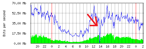

this is graph of wlan R52Hn mounted on a RB411AH stop working its like all clients are connected but no RX/TX data

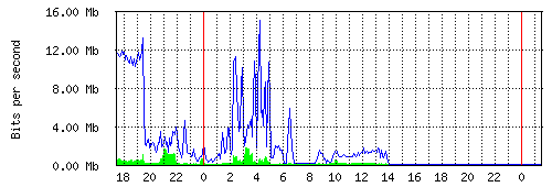

this happen also on some Rbords on ethernet ports, RB is running no hang ups when I connect in from wireless side I see that there is no passing any data from ethernet port
like this ether1 on RB493AH

just I have to do disable enable interface or reboot RB and everything is back to normal

on sec picture is RB493AH all interfaces wlan1 ether1-ether9 are in bridge just using ether1(for now)
