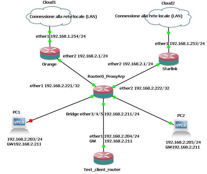

Ok, I (sort of) managed to reproduce your second setup in GNS3 and the good news are that it (sort of) works.
I introduced two “very simple” routers between the “main” router (which I called “Router0_proxy_arp”) and the “Cloud” of GNS3 (giving it “your” names of "Orange and “Starlink” and changed your 192.168.1.x addresses to 192.168.2.x.
Layout attached.
In this setup only the ether1 and ether2 of “Router0_proxy_arp” need to be set to arp=proxy-arp, AND the setup works just fine WITHOUT the two static arp entries you added in your original configuration, the arp entries are added dynamically.
Configuration of router “Orange” (as simple as it can be):

Configuration of the “main” router “Router0_proxy_arp”:

Now, I can ping/trace 8.8.8.8 from the two virtual PC’s, from the test router (besides of course from Orange, Starlink and Router0_proxy_arp), though I am still not sure about how/why exactly it works (but I can confirm that setting the ether 1/2 of Router0_proxy_arp to “enabled” connections are lost, so the proxy-arp is doing its magic :smiley: ).
In “normal” operation, routes on Router0_proxy_arp are:
[admin@Router0_proxy_arp] /ip/arp> /ip route print
Flags: D - DYNAMIC; A - ACTIVE; c - CONNECT, s - STATIC; + - ECMP
Columns: DST-ADDRESS, GATEWAY, DISTANCE
#      DST-ADDRESS     GATEWAY             DISTANCE
0  As  0.0.0.0/0       192.168.2.1%ether1         1
1   s  0.0.0.0/0       192.168.2.1%ether2         2
  DAc  192.168.2.0/24  bridge                     0
  DAc+ 192.168.2.1/32  ether2                     0
  DAc+ 192.168.2.1/32  ether1                     0
Switching off router “Orange” does not change routes.
Disabling the link in GNS3 between Router0_proxy_arp and “Orange” switches routes very fast to:
Flags: D - DYNAMIC; I - INACTIVE, A - ACTIVE; c - CONNECT, s - STATIC; H - HW-OFFLOADED
0  IsH 0.0.0.0/0       192.168.2.1%ether1         1
1  As  0.0.0.0/0       192.168.2.1%ether2         2
  DAc  192.168.2.1/32  ether2                     0
  DIcH 192.168.2.1/32  ether1                     0
(which is the expected result)
As well, resuming the link in GNS3 changes them back very quickly.
Same happens if I disable and re-enable ether1 on Router0_proxy_arp.
If I disable the ether2 on router “Orange” as well routes do not change.
So - at least in the GNS3 simulation - the failover function is working “strangely”.
I will see if I succeed in experimenting with some “more advanced” failover methods.
