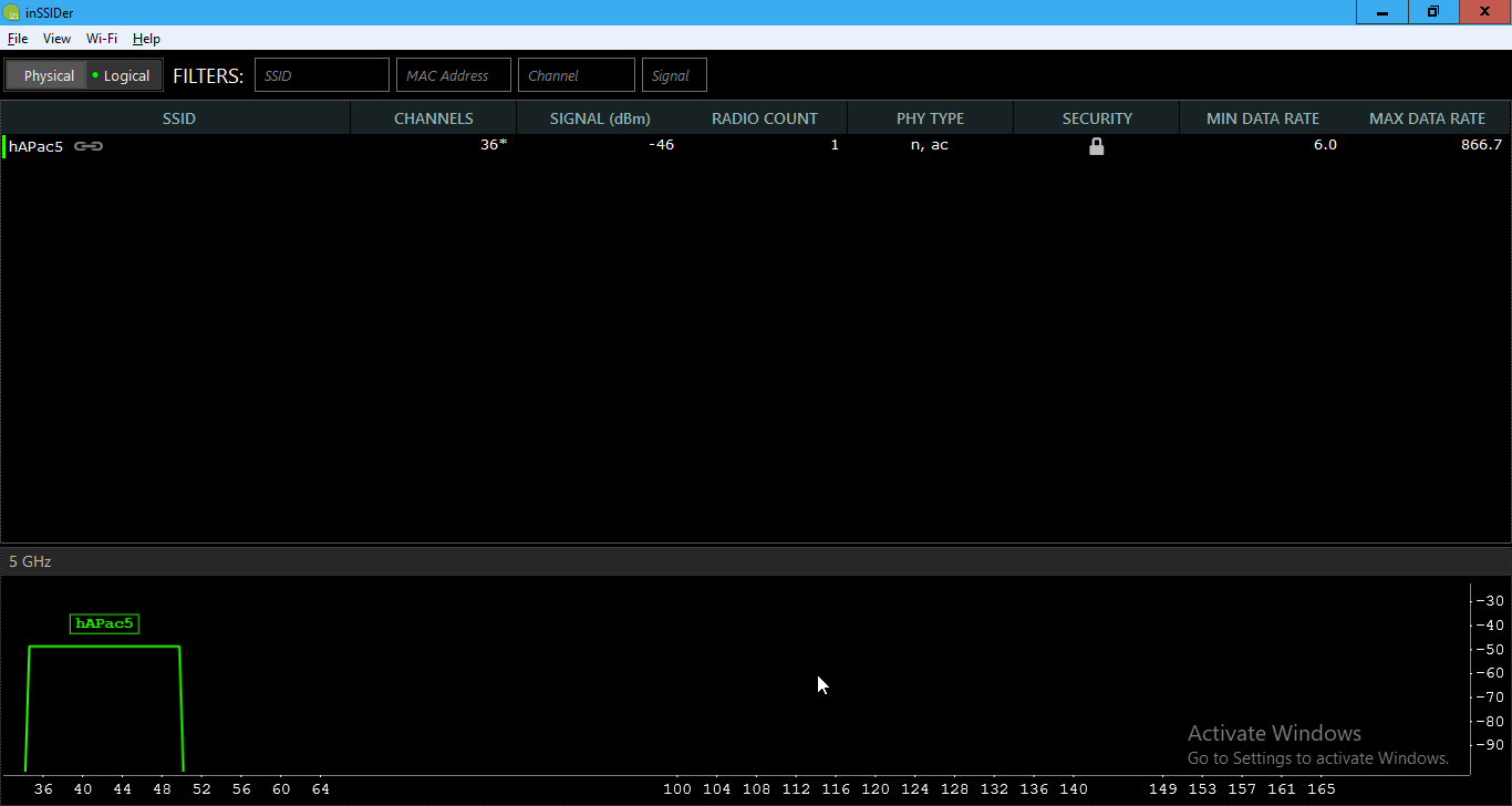

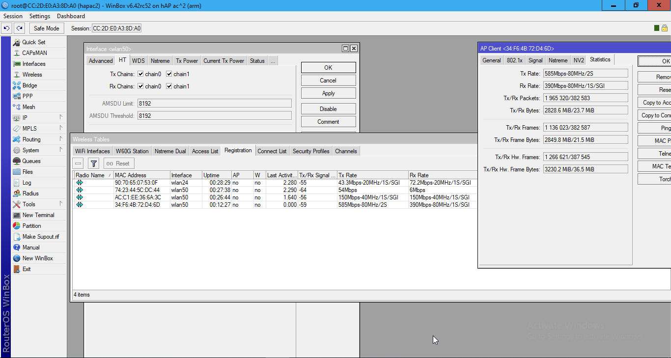

Can you provide more detail statitic ?
  1. registration table statistic : http://forum.mikrotik.com/t/mikrotik-cap-ac-performance-review/117477/22
  2. registration table signal : http://forum.mikrotik.com/t/bad-wireless-reception-with-rb2011uas-2hnd-in/62979/1
  3. chanel overlap http://forum.mikrotik.com/t/bad-wireless-reception-with-rb2011uas-2hnd-in/62979/1
  4. speed test results
  5. which equipment you are using
  6. which ROS version

It’s not Wi-Fi link issue.
It’s LAN-WiFi 5GHz issue, because bought Laptop and Phone shows the same problem with LAN-WiFi 5GHz connection.
And there was NO the issue like described with hAP ac.

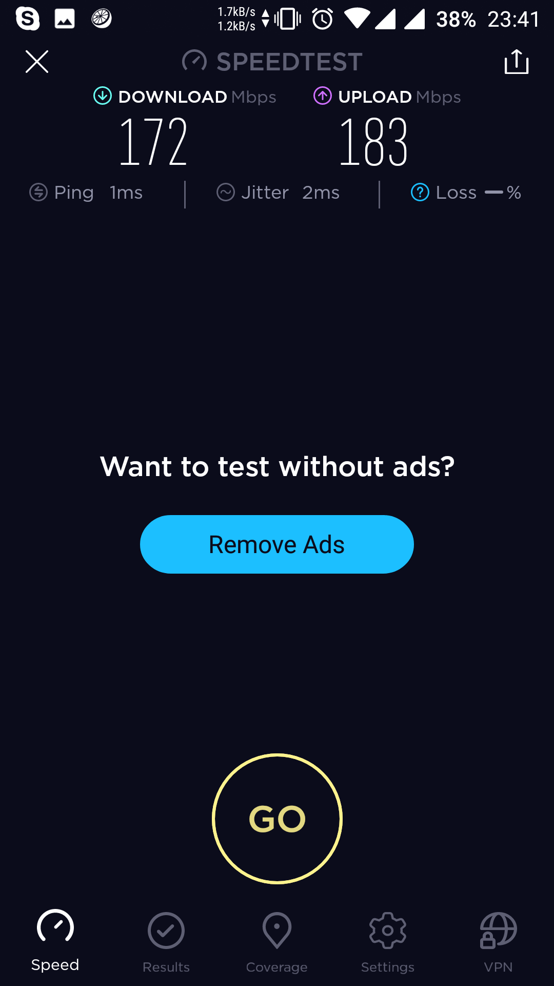

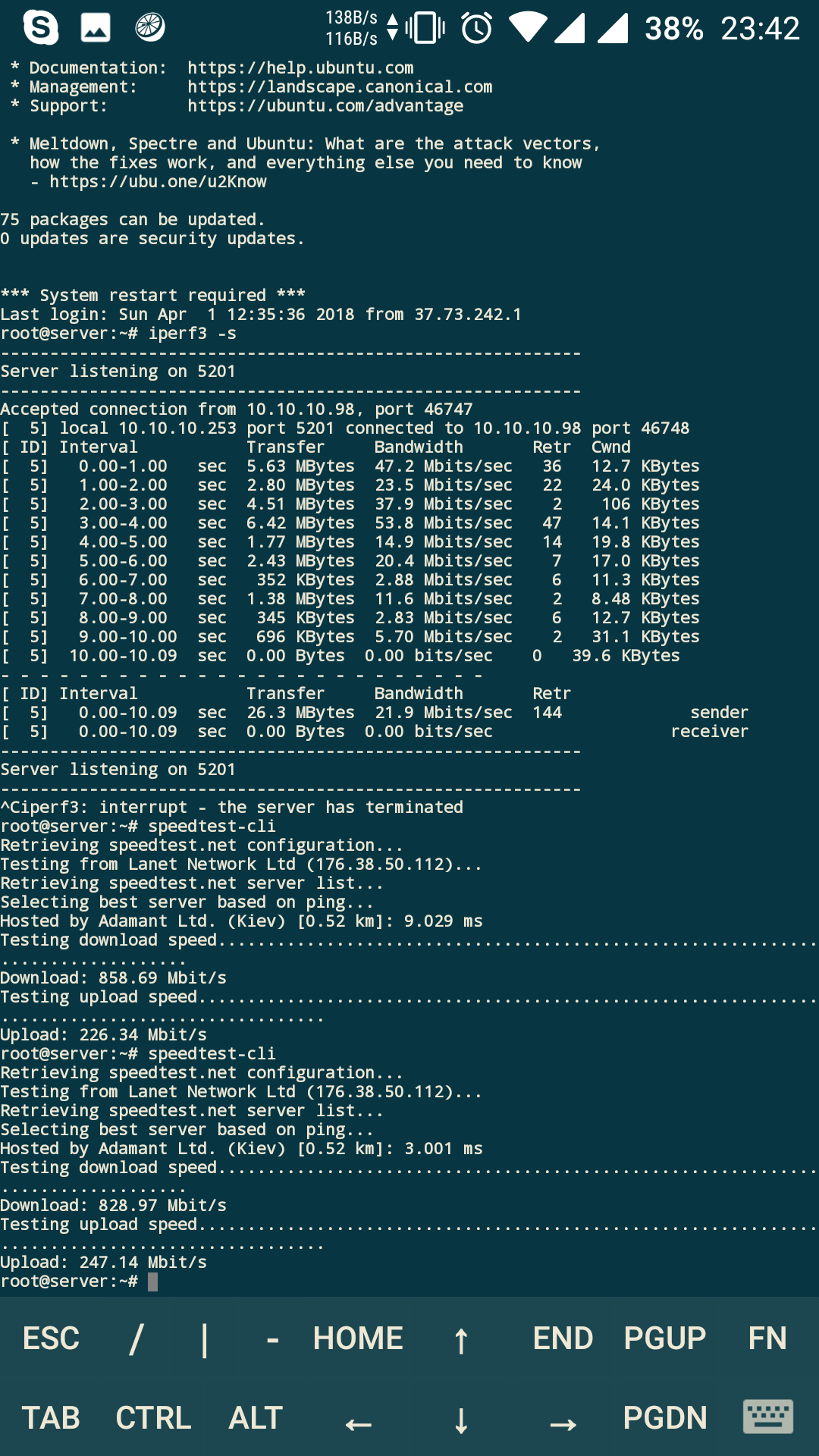

The same tests with my phone and server.
Upload speed from server is lower, because vlan is configured for internet connection, BTW why so slow?
With default ROS config speed is around 800..900 Mbps up and down (from server to internet and backward).

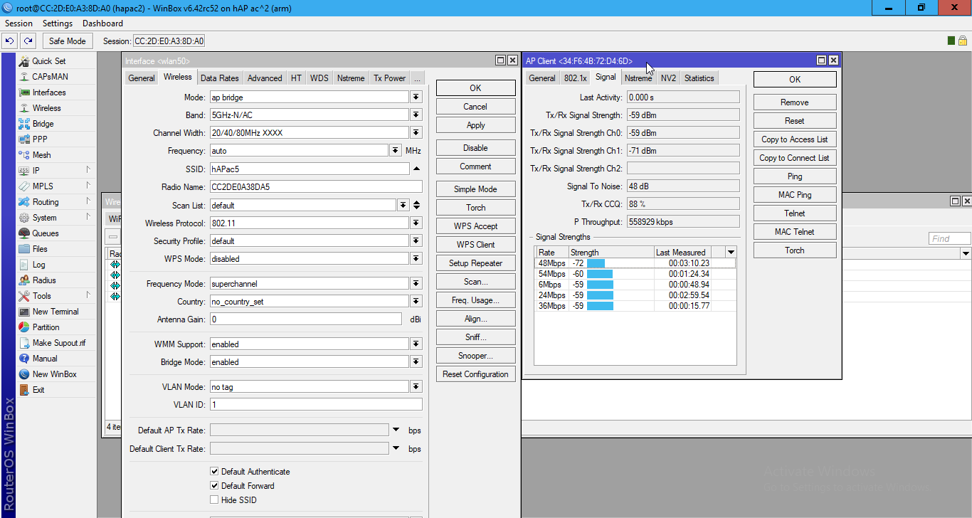

Can you perform test with changed chanel width?
Ceee5180
eCee5200
eeCe5220
eeeC5240
Also Intel 7260 slow performance :
http://www.troublefixers.org/laptops/fix-intel-wireless-7260-ac-wifi-speed-issues-in-windows-10/679/
https://communities.intel.com/thread/59726
Intel 7260 slow - ha-ha!
It works perfectly with hAP ac (I got stable 200..220 Mbps with it) and many other routers. As well as Xiaomi Redmi Note 3 works perfectly with hAP ac (on 5GHz).

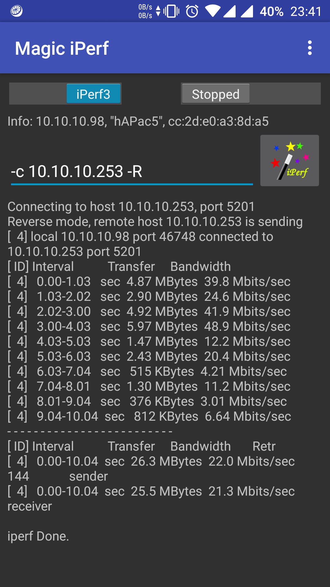

The test results you asked for are below, as expected nothing changed.
Also, please check this link http://forum.mikrotik.com/t/hap-ac-2-problems-extremely-poor-performance-found-in-2-4g-and-5g-wifi/118063/9
C:\Users\nemof\Desktop\iperf-3.1.3-win64>iperf3.exe -c 10.10.10.253 -R
Connecting to host 10.10.10.253, port 5201
Reverse mode, remote host 10.10.10.253 is sending
[ 4] local 10.10.10.95 port 53670 connected to 10.10.10.253 port 5201
[ ID] Interval Transfer Bandwidth
[ 4] 0.00-1.00 sec 4.97 MBytes 41.6 Mbits/sec
[ 4] 1.00-2.00 sec 3.87 MBytes 32.5 Mbits/sec
[ 4] 2.00-3.00 sec 4.38 MBytes 36.8 Mbits/sec
[ 4] 3.00-4.00 sec 2.87 MBytes 24.1 Mbits/sec
[ 4] 4.00-5.00 sec 3.67 MBytes 30.7 Mbits/sec
[ 4] 5.00-6.00 sec 2.29 MBytes 19.2 Mbits/sec
[ 4] 6.00-7.00 sec 2.65 MBytes 22.2 Mbits/sec
[ 4] 7.00-8.00 sec 2.31 MBytes 19.4 Mbits/sec
[ 4] 8.00-9.00 sec 3.33 MBytes 27.9 Mbits/sec
[ 4] 9.00-10.00 sec 3.19 MBytes 26.8 Mbits/sec
[ ID] Interval Transfer Bandwidth Retr
[ 4] 0.00-10.00 sec 34.3 MBytes 28.7 Mbits/sec 70 sender
[ 4] 0.00-10.00 sec 33.7 MBytes 28.2 Mbits/sec receiver
iperf Done.

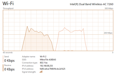

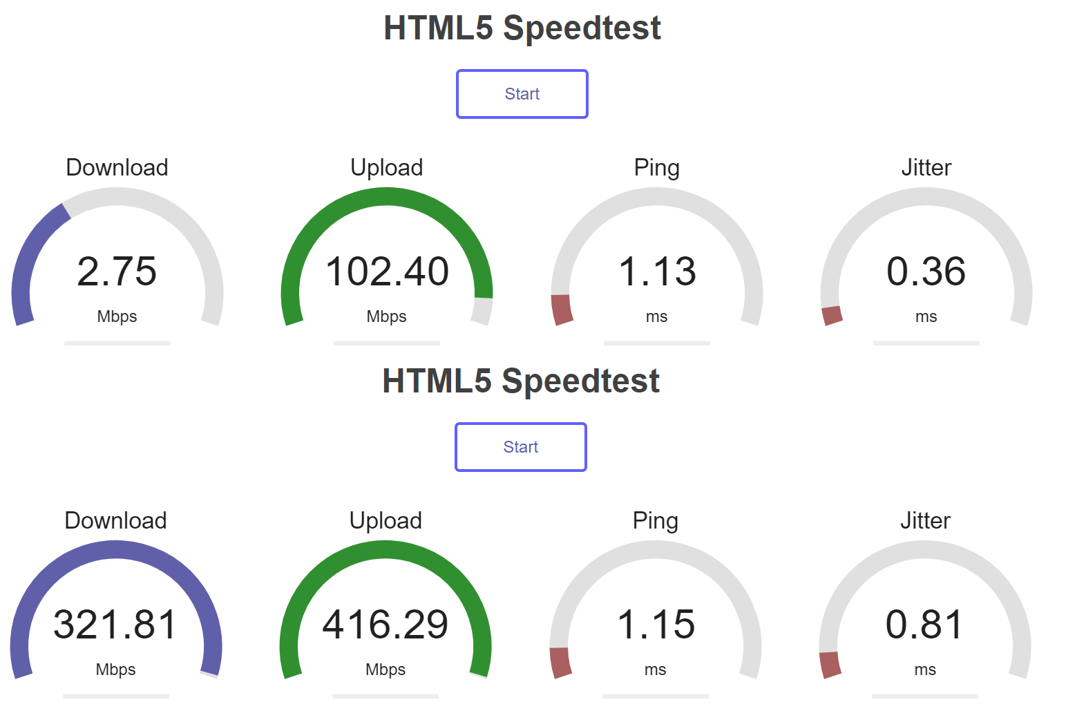

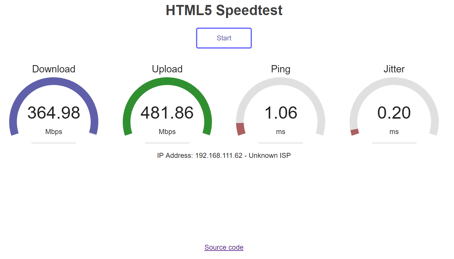

equipment mounted pointing up !!!with very good speed…
so there is two tests, one test and after few seconds - second test.
no change, no move just chrome open new tab and repteat test
so wehere is comment from MT ? :smiley:

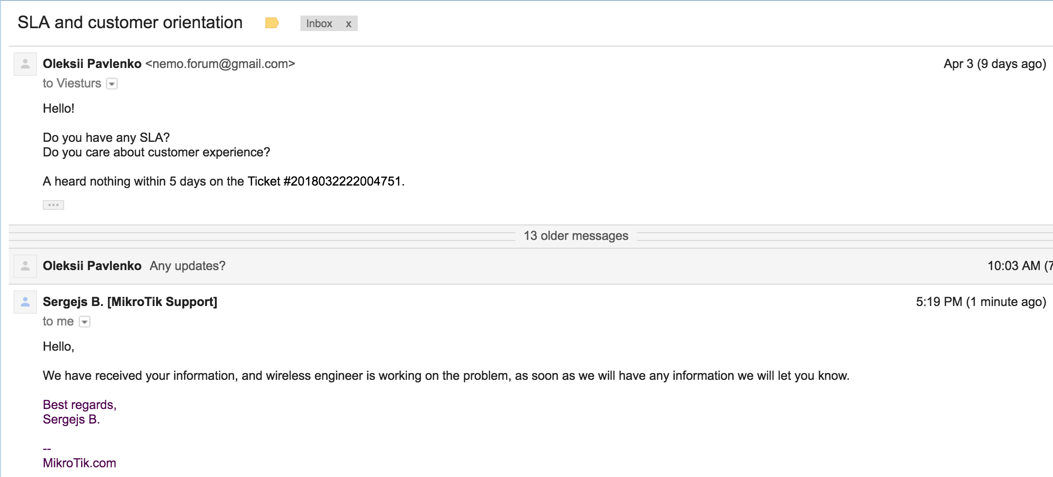

I’m a bit tired repeating this again and again, but…
This is a user forum. Period. Mikrotik staff may occasionally answer some questions here, but they do not have to. If you need an “official answer” you should write you question to support@. I’m afraid that’s the only “official way” to ask you questions.

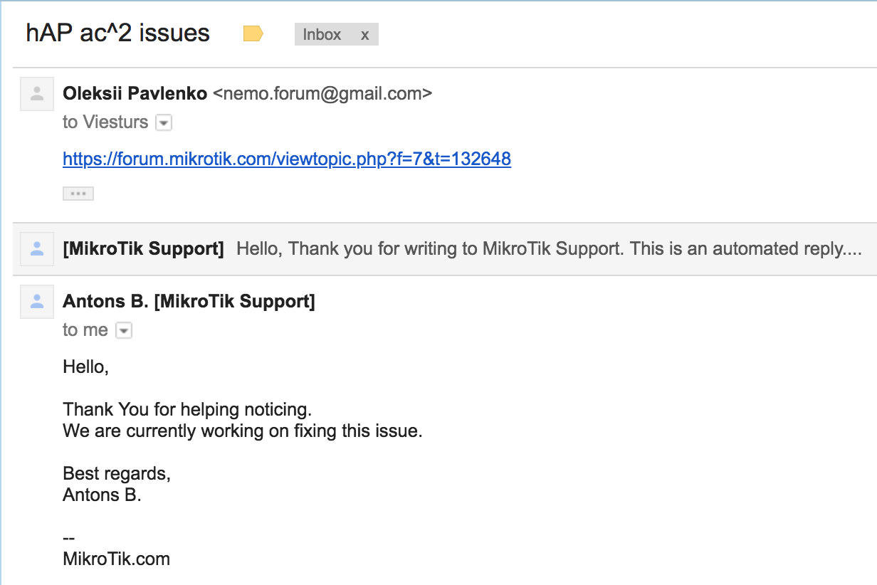

Have you got any reply from MikroTik Support?
YH
The first valued answer since 29 March.
andriys: as you are an official MikroTik employee, could you please raise up an idea of creation an official communication channel MikroTik → users? IMHO if everyone who has any question should write to support@ then you would not do anything else just responding to e-mails.
I (and definitely I am not the only one) think that this could be beneficial to both - MikroTik and also its users.
It seams the email to support is the only way, because they have a ticketing system there and maybe some people that do the filtering above that to ensure nothing will be lost and everything will be replied at least somehow. I think that such way is quite secure but not fast enough. Other ways could loose tracking. And as you see, mikrotik is able to react officially here on the forum if they wish. Unfortunately they do not wish at given time or do not know how to react many times.
