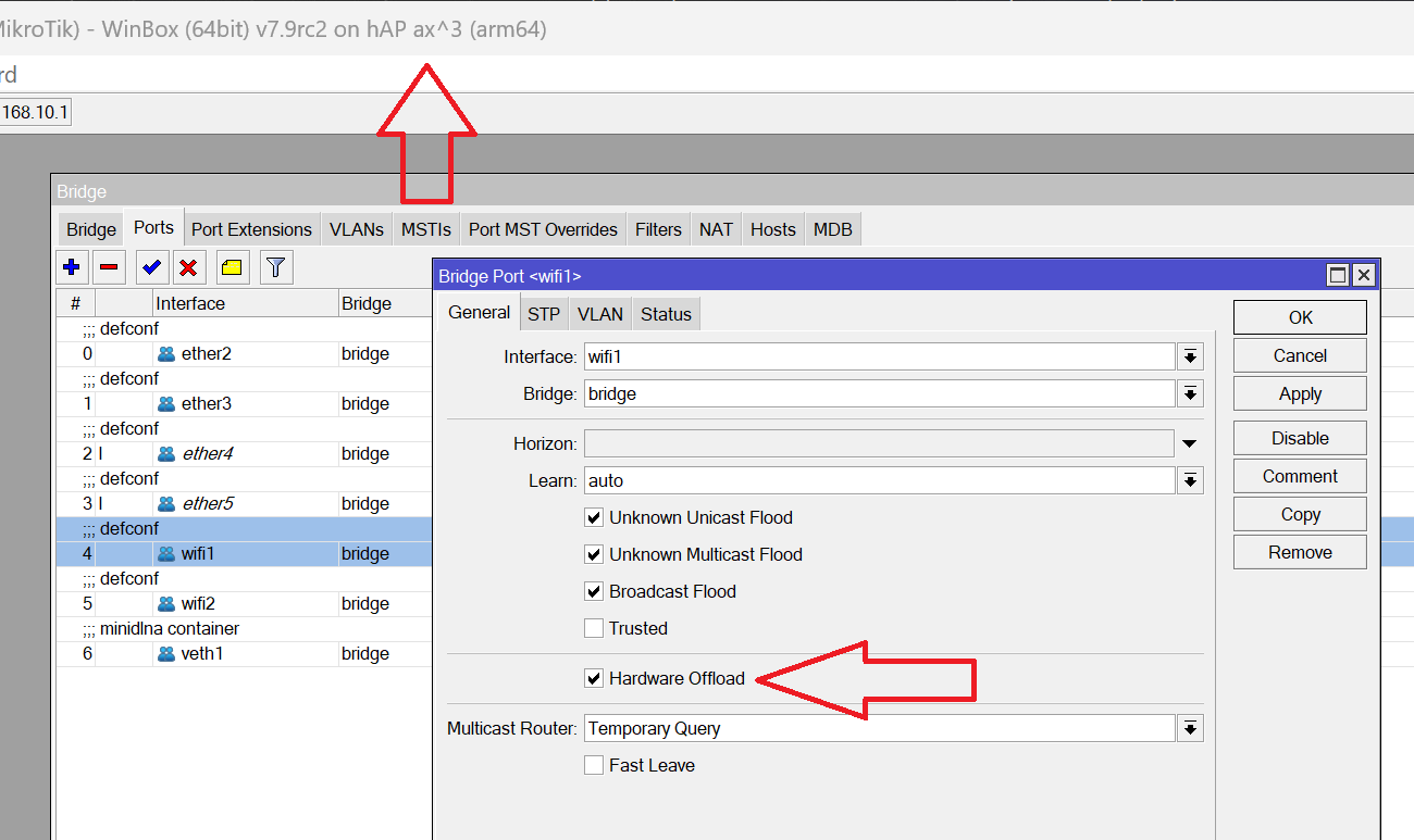

I’d also recommend making sure that hardware offloading is disabled, and checking if different frequencies produce better results.

Do you mean this which is active by default in all interfaces?

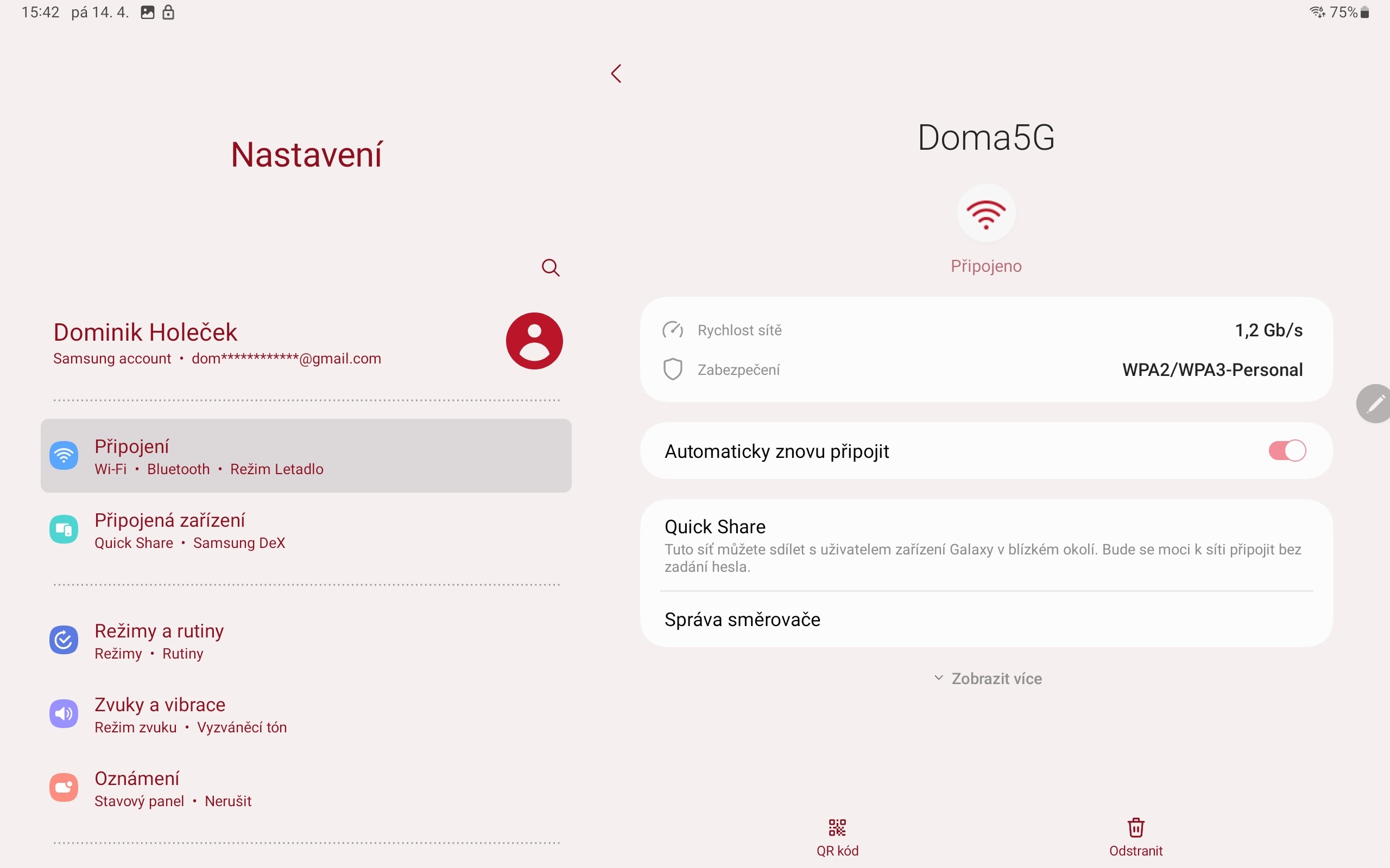

I’ve been doing some additional configuring and testing, and yet nothing seems to have improved the speed whatsoever. I used various frequencies (I’m even lucky enough to have most of the 5 GHz band “free”, so no other AP should cause an inteference), locations of the AP and devices, but no luck. The (download) speed is always around 200-400 Mbps (the best result I obtained was about 450 Mbps using my WiFi ax laptop) using iperf3, SMB transfer and Speedtest.net. Testing via Speedtest.net sometimes shows much better upload speeds (reaching 700-800 Mbps) but it seems to be unrealistic as iperf3 and transferring files using SMB indicates the speed is always below 300 Mbps (using smartphones/tablets) and below 450 Mbps using laptop.
Moreover, I noticed, the Wi-Fi signal strength seems to be an issue, at least when using correct country settings (= Czechia) - 2 meters away from my AP (directly in front of it with no obstacles), I get about -60 dbm using 5 GHz. This might be the reason why I have a rather low theroretical troughput (link speed) - usually about 600-800 Mbps when using devices in the same room. I get 1,2 Gbps only when I’m few centimetres from the AP, and yet even then the speed is the same. With no country set, the Wi-Fi strength seems to be better, but the speed is still the same.
Here’s my current config using 7.9 RC3. (Mostly set via Quickset)

Out of curiosity, what devices were used? I’m having troubles reaching even half of the speed you get… (I used every device in my household with Wi-Fi ax - 2 iPhone’s 12 Pro, Samsung Galaxy Tab S8, Samsung Galaxy S20+ and Thinkpad E14 Gen 3 with MediaTek Wi-Fi 6 MT7921)
That’s what I’d like to get, and some people claim they reach such speed with Hap AX2/AX3, and yet the rest of us (I’m definitely not alone) have troubles reaching even half of the speed… :slight_smile:
