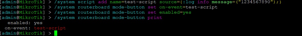

/system script add name=test-script source={:log info message=("1234567890");}
/system routerboard mode-button set on-event=test-script
/system routerboard mode-button set enabled=yes

The content of this field is displayed with syntax highlighting. Things become colored if you use something like:
/system routerboard mode-button set on-event="/system script run test-script;" enabled=yes
As a fallback RouterOS tries to run a script with given name. It’s the same for the scheduler… Just giving a script name makes on-event appear in red.

I don’t think you need to do
/system routerboard mode-button set on-event=/system script run your-script
In my case it worked just giving the script name directly to the on-event= like so
       /system routerboard mode-button set on-event=your-script
Yes, that’s enough for things to work. The above was my example to explain why things are shown red and how to work around. :wink:
