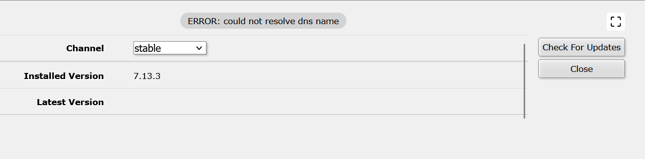

But the ROS update check does not work either - “ERROR: could not resolve dns name”

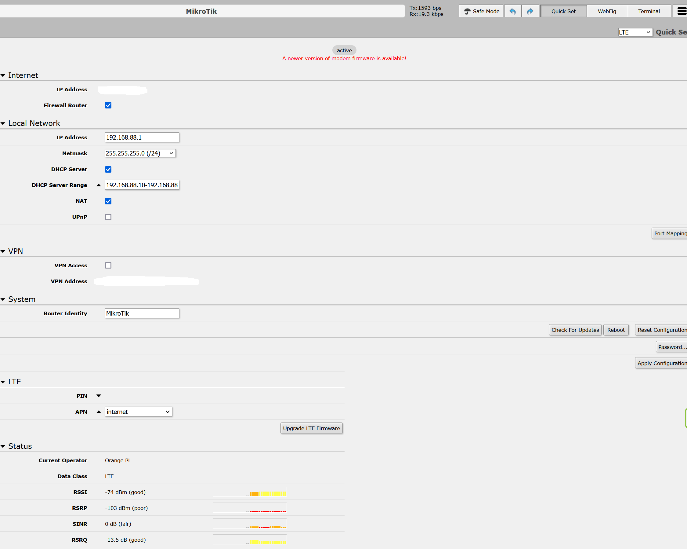

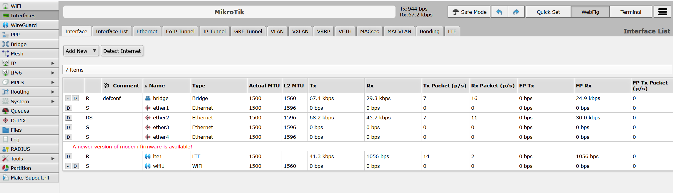

Where should I start checking, this is what it looks like:

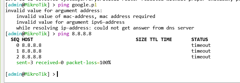

Check DNS settings for starters.
If needed, manually add 8.8.8.8 or 8.8.4.4 to be 100% certain there is something which works (at least, it should).

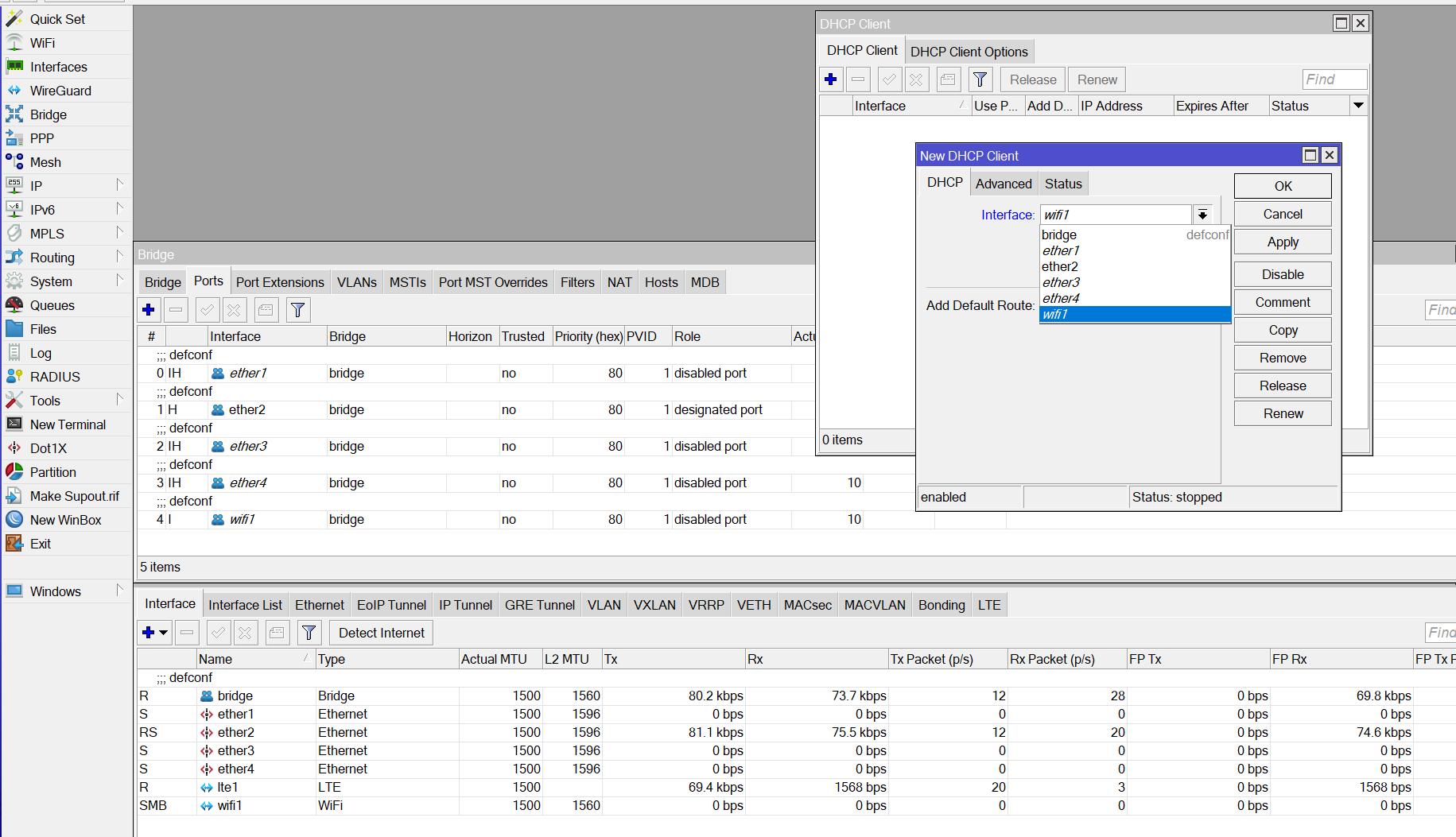

I wanted to add a DNS client, but I don’t have the “lte1” option to choose from the interface list. If I choose “bridge” it does not work.
But when I set it to “bridge” and connected the Internet to the ETH1 port, the router had access to the Internet, downloaded and installed the modem firmware update
