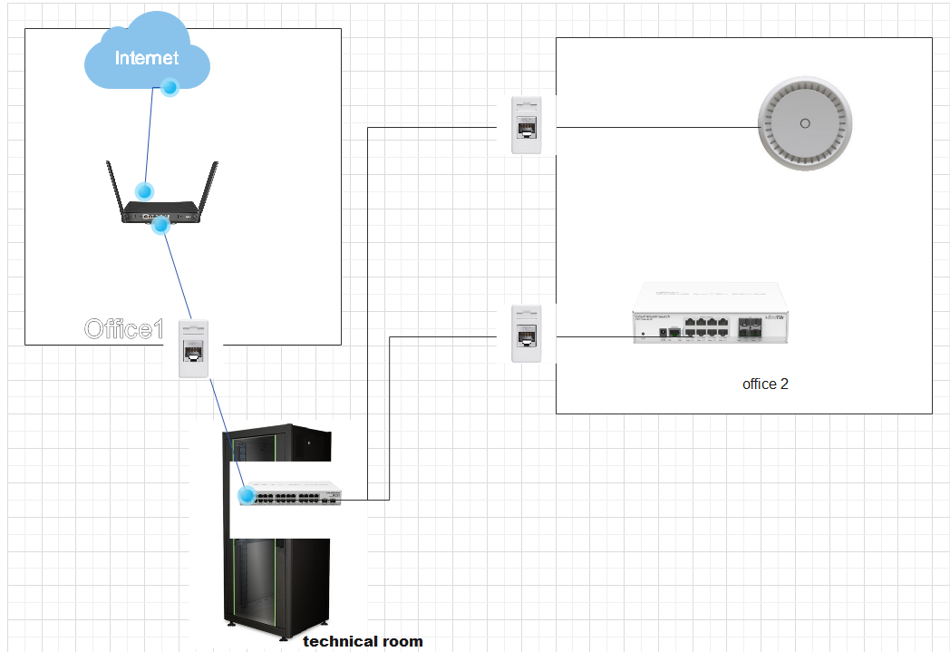

I have attached a diagram of the current network configuration (i hope that u understand what i have draw). Currently, I aim to establish a Wi-Fi network primarily focused on enhancing the performance of the access points (APs) to strengthen the Wi-Fi signal within office 2. Could you please guide me on configuring the APs to achieve this objective
for the moment we just want to make it work then i will come back with other question .

So far this is an easy case of pcunites bridge vlan filtering.
All vlans, one bridge FOR ALL THREE MT devices.
Trunk port on ax3 to trunk port on switch.
Trunk port on switch to trunk port on capac ( consider configuring cap on the bench next to the PC using ether2 (offf bridge) prior to installing ( also if not easily accessible, wire up ether2 like ether1, to a location where you can easily plug in with a laptop )
Trunk port on switch to trunk port on CrS310
Management vlan99 is passed to both devices and this is the subnet they get their IP address from.
I can set this up for both the cap and the CR310 in five minutes each.
Ask me to do capsman on top… give me a week LOL.
