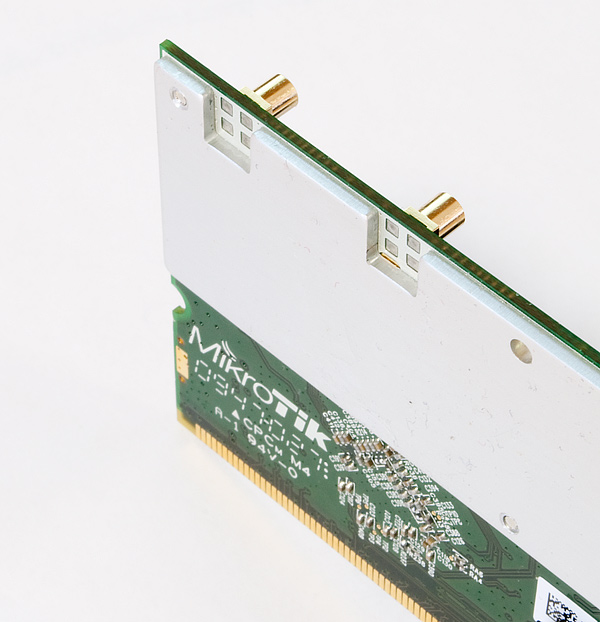

MMCX are THT?
yes, it also has ESD protection on the ports, which is not mentioned on your datasheed. We will fix the PDF.
back side of the card, for the ones interested in the connectors and heatsink
