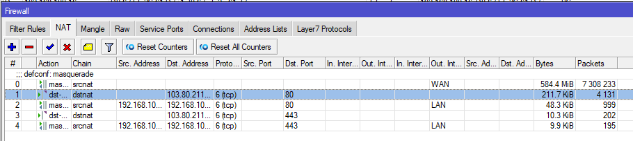

I installed ssl for my webserver. When I use https protocol, it throws an error, “Unable to connect to server”. The ssl server test from ssllabs.com, says “If failed to connect to the server, it usually happens due to firewall restrictions.” I added the following 2 NAT rules for ssl, which has port of 443.
Obviously, something goes wrong here. Please help me.

add action=dst-nat chain=dstnat dst-port=443 in-interface-list=WAN log=yes protocol=tcp to-addresses=192.168.10.X to-ports=443
Can you explain the meaning of your rules?
You can see that the rule has some hits. So if it’s just a copy of rule for port 80 (which I assume works) and only the number is different, then this one must work too and the problem is probably elsewhere (server’s own firewall for example).
A full view of the config is best to determine what may be blocking the traffic.

I added the last two rules (3 and 4) for port 443. The third rule is exactly what you wrote, and the fourth rule is for the local connection to the server.

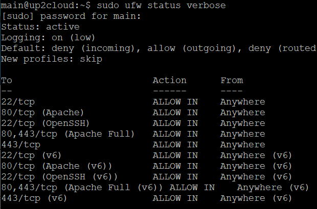

Yes, I copied rules for port 80, only changed port number to 443. My web server’s firewall is open for port 443.

Do you test it from LAN? Rule for port 80 has in-interface-list=all (which is useless, because it always matches, so you don’t need to add it at all), but for 443 you have in-interface-list=WAN, so it will work only from internet.
