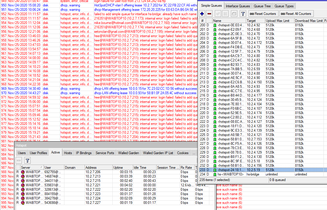

Recently had an issue with a few customer sites, where users were not able to grab an IP address in wired or wireless vlans. Looking at the logs I could see this in red repeating on a regular basis.
internal error: login failed: failed to add queue: already have such name (6)

Original post you link to on hsnetworkmanager is mine. That was in Feb, it died down over a few months (probably COVID) but now that we’re cranking back up for xmas it’s starting up again. It appears as if dynamically created Queues from RADIUS Auth are not flushing post logout. I have 8 Active Hotspot clients but 235 Queues. Posting on both forums to see if anyone has some insight.
I’m having the same issue where the queues that are dynamically been created with user-manager does not get removed after they disconnect from the server thus that user cannot connect again and I have to reboot the router.
