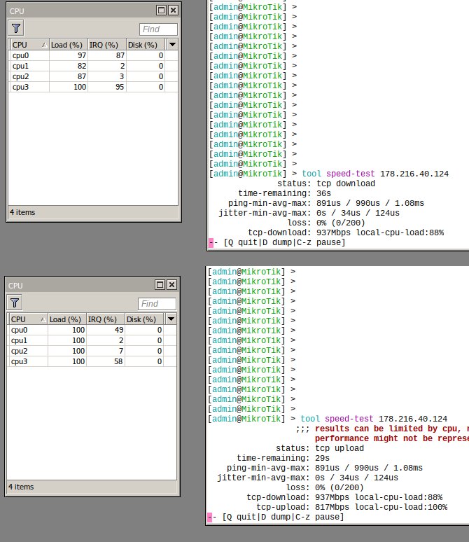

I have the RB4011 and hAP ac2 connected directly via an ethernet cable.

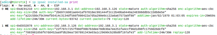

4011 is the gateway for ac2, with ac2 I perform a bandwith test to the server and the local traffic exchange node. It then gets almost 1Gb/s and all cores in ac2 are maximally used. However, when I encrypt communication 4011 ↔ ac2 I get only 200Mb/s where on the product page ac2 is written about 400Mb/s interestingly during tests with IPSEC the processor in ac2 is used at only 45% (one core 100% two 40% and the last 0%). Both devices are ROS version 6.45.1.
In the attachment I am sending a screen with tunnel parameters.

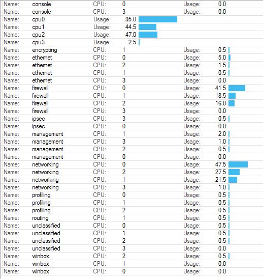

By “incomplete use” I meant that the processor with IPSEC enabled was not fully used.
Honestly, I would not look for problems with MTU. More with h2 ac2 performance.

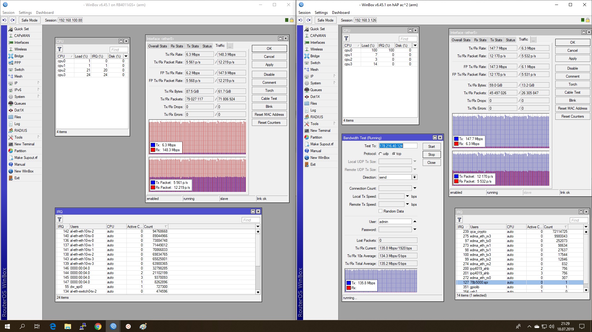

In the attachment I am sending screen of devices between which I am doing the test.
I am wondering about IRQ called qca_crypto. As if IPSEC was supported by software and not hardware.
On the left you can see 4011 (both devices work on ARM processors) and there is no such IRQ.
Looks like you’re testing single core performance of a hAP ac2 by single threaded b-test here.
Ok, but see results with IPSEC off - the traffic spreads to all cores.
With IPSEC enabled one core is maximally saturated and the rest have a power reserve.
I cannot imagine Mikrotik intentionally publishing inflated test results, I can imagine them (like any other vendor) to publish results obtained under ideal conditions (which @Emils has suggested). So I’ve suggested my real experience. It’s not “problems with MTU”, it’s how fragmentation affects network performance in general. Note that the issue is so significant that IPv6 has changed the rules how fragmentation may be handled.

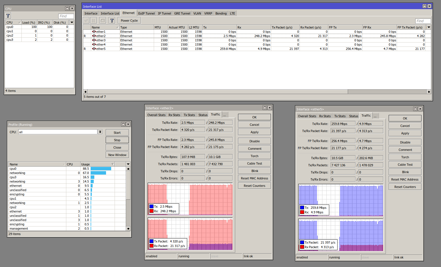

(147.700.000 Mbits/s / 12.170 packets/s) / 8 bits/byte = 1517 bytes/packet, which means that the fragmentation is not the issue here - if it was, the result would be around 800 bytes/packet.
So @McSee’s suggestion is the next one to deal with, as in the btest manual you can see a Note:
Bandwidth Test uses a lot of resources. If you want to test real throughput of a router, you should run bandwidth test through the tested router, not from or to it.
The IPsec performance degrades when it has to rearrange received packets, which is why the sending direction of any given SA is forcifully handled by a single core, and also all handling of any given packet tends to be done on a single core for performance reasons. So chances are high that btest sends the packets using the same core which encrypts them, maxing that core out.

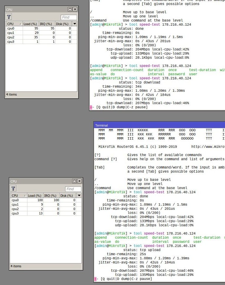

However, even after you have applied the steps you used, the speed is still around 230Mbps.

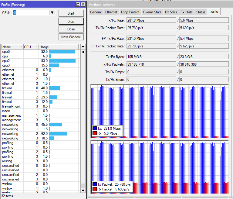

Performs iperf3 from a computer on the local network. On hAP ac2, connecion tracking is off.
ehter2 - LAN
ether5 - WAN
When using multiple IPSEC connections side by side the traffic tends hurdles still together on one core.
I’ve used this information to double-check on your screenshot that the number of bytes and packets is similar on the plaintext (ether2) and encrypted (ether5) side, so I’m officially out of ideas.
