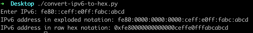

Python3 Script to convert the IPv6 address of your DNS to HEX format in /ipv6 dhcp-server option
Install ip address module https://docs.python.org/3/library/ipaddress.html
#!/usr/bin/python3
# https://docs.python.org/3/library/ipaddress.html
# ^^ pip3 install ipaddress
import ipaddress
ip = input('Enter IPv6: ')
ip=ipaddress.IPv6Address(ip).exploded
print(ip)
iphex = ip.replace(':', '')
print('0x'+iphex)

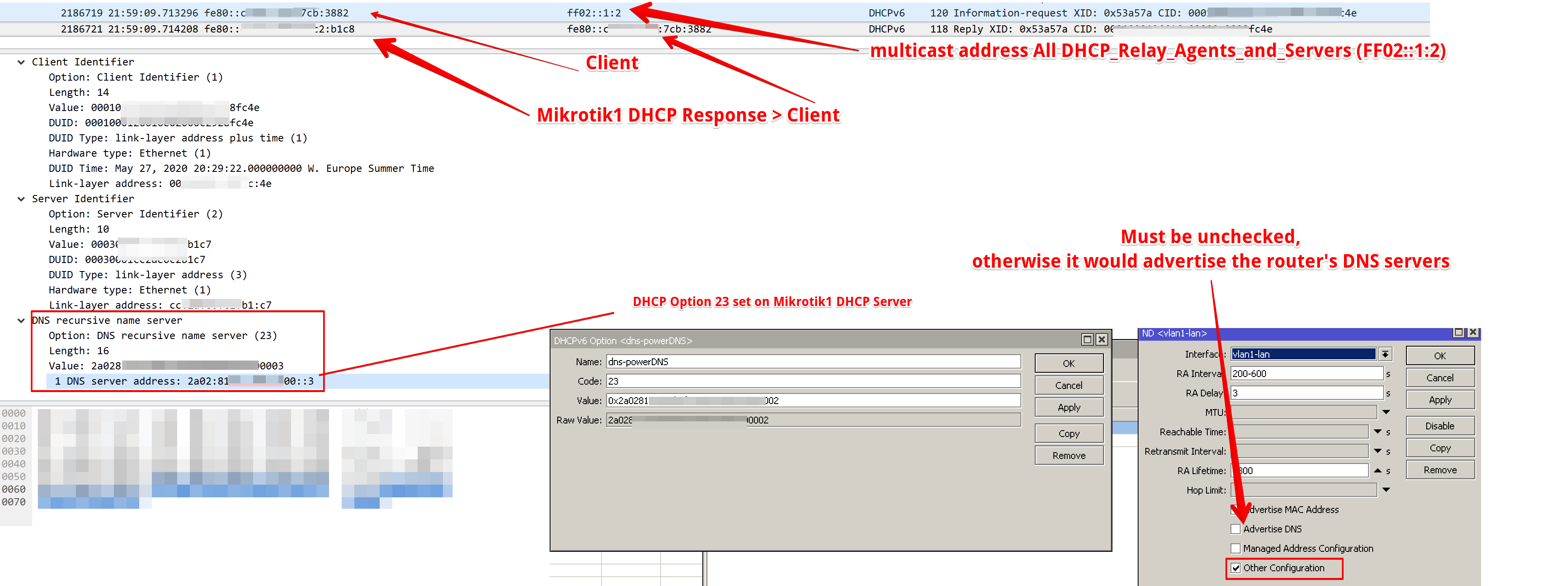

For those who’re interested how this looks in Wireshark when it actually working:
