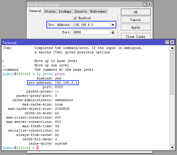

Issue:
Source IP of web proxy can’t be configured in WinBox and WebFig. Configure it in terminal is Ok.
Description:
Configure source IP address of web proxy in Web Fig will simply not show. Configure it in WinBox will course inconsistency display of WinBox and Terminal, and it does not become effective. Will be lost after close WinBox.
Versions affected:
6.5, 6.6
How to reproduce:
Notes:
None
Support TicketID:
Submit this post as a bug report to MikroTik Technical Support
