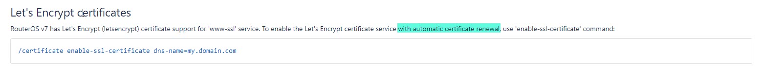

Is there any known reason why my certificate is not being renewed automatically?
WWW is enabled, and the firewall rule looks okay to me.

I am experiencing the same issue as OP, In Firewall filter dstTCP80 is accepted on input. www service on port 80 is enabled. After issueing
/certificate enable-ssl-certificate dns-name=domain.example.com
i get the following result:
progress: [success] ssl certificate updated
cert is renamed but not renewed. Now it is expiring in 3 days. ![]()

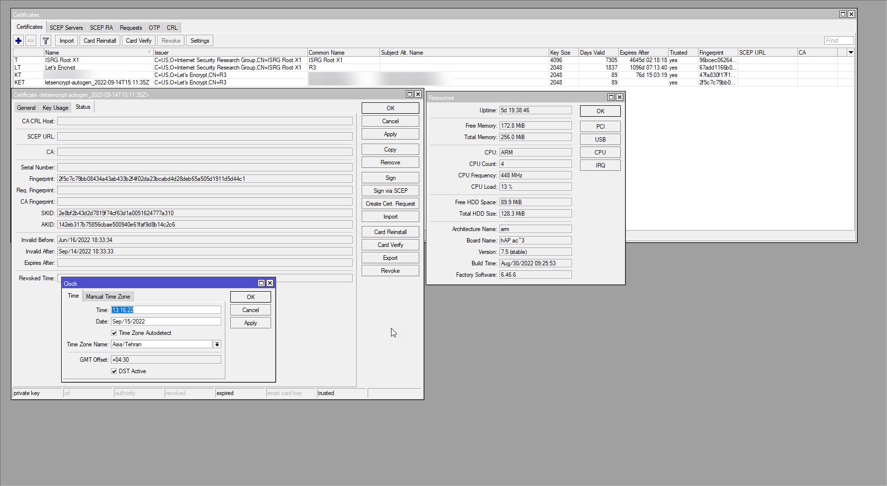

what is even weirder “expires-after” fields does not match in cli and winbox. CLI shows 1w4d while winbox shows 3d
