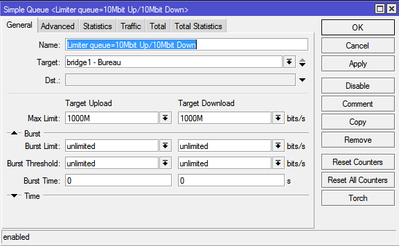

So this solution isn’t correct:
http://pastebin.com/jNmr8e6A
No. You wrote that your download speed is 1Gbit(1000Mb). If that really is the case, then 1000Mb is your download max. limit. If your upload speed is also 1000Mb, then this is Your upload max limit. Your PCQ upload/download queues seem ok. Just add them in the Advanced tab under Queue Type.
Look at the pictures in the attachment.
