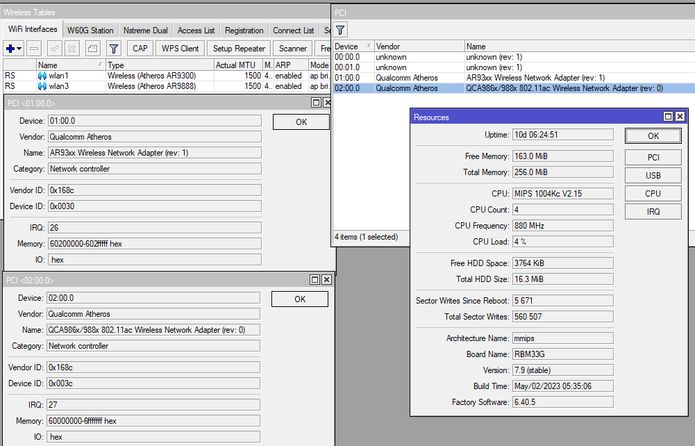

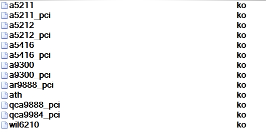

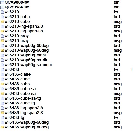

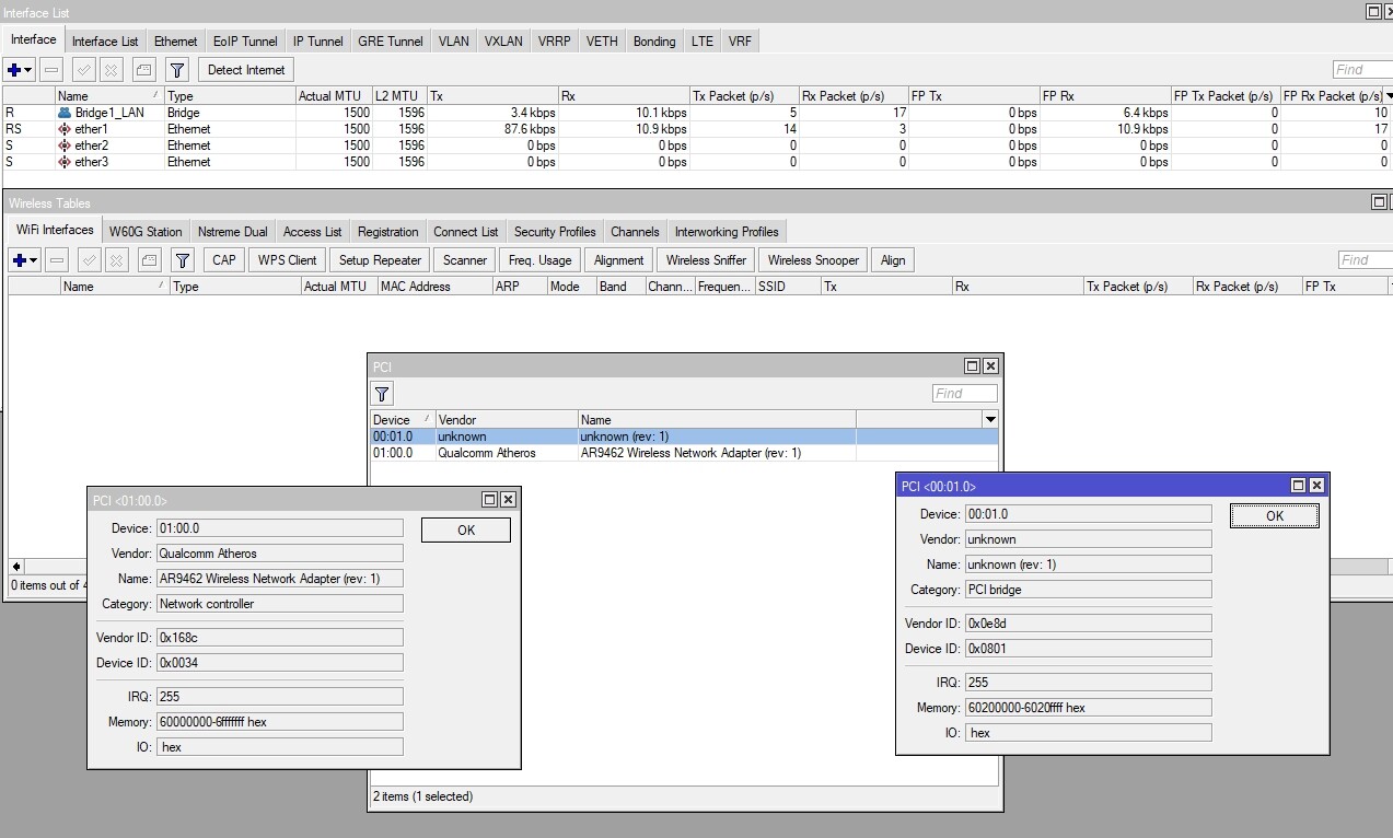

At the moment, after reading numerous forum threads and other sources, I have come to understand that it is possible to unpack a firmware image using an archiver tool and explore the “wireless” directory. In that directory, there is a small list of modules: AR5211, AR5212, AR5416, AR9300, AR9888, QCA9888, QCA9984, WIL6210, which are likely to be supported, but I’m not entirely certain. All of them are based on Atheros and Qualcomm chips. There may be other models that could potentially work on MikroTik devices. I hope there are modules with Bluetooth support as well. This would be beneficial for those involved in IoT. Here is an example of how a module is identified in devices, although it may not appear in the interfaces, even if it is based on Atheros and Qualcomm chips.

Yes, ONLY chipsets with specific drivers (ie AR5211, AR5212, AR5416, AR9300, AR9888, QCA9888, QCA9984, WIL6210) have chance to work. No other will be recognized at all like you show on your screenshot, even if it’s similar family or generation. Devices listed in PCI resources are just that: list of PCI devices. It only shows card was recognized and it’s correctly plugged in, but there is no driver for it. Same would happen if you plugged in GPU or HBA card using riser, it would appear in PCI devices list, but otherwise not do anything.
But even when using wlan card that have supported chipset doesn’t mean it will work. Difference in eeprom might be the cause or some vendor customization of tx/rx chains. Dumping eeprom from Mikrotik card and using it in the same chipset oem card might work… or not.

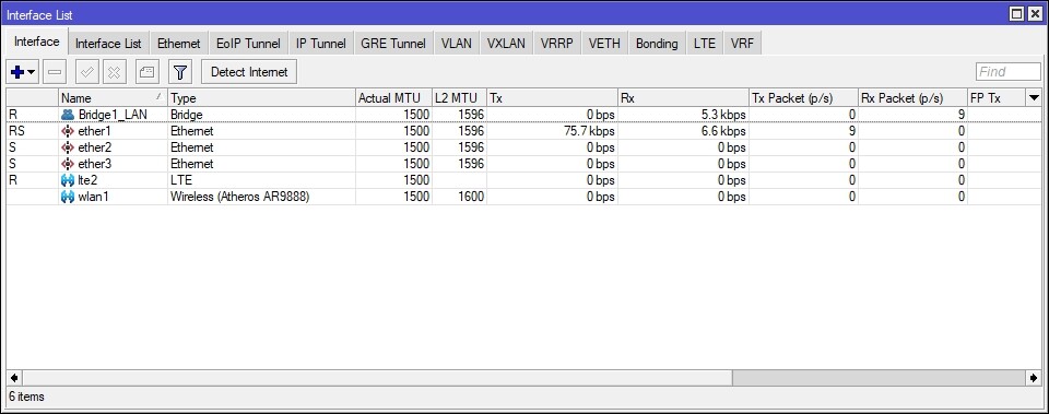

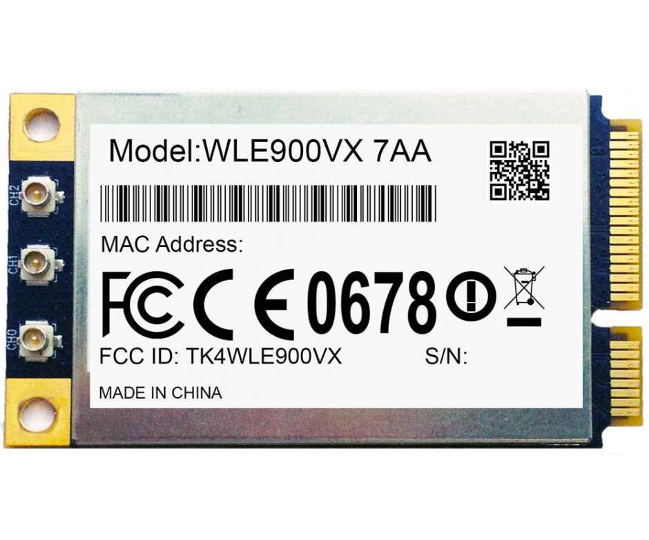

I’ve used a lot of adapters based on AR93XX, AR98XX and they all worked correctly! Example:
That’s good to hear, it’s pleasing. I see one module. It seems to be the Compex WLE900VX. It has three antennas. Do I need to connect all three antennas at once? Does it have Bluetooth capability?
I cannot identify the second module. Could you provide its model, and I can assist you with the same questions regarding antennas and Bluetooth capability?
Can the first module be used with only two sector antennas?
yes, of course. You can turn off chains in advanced options, can even assign different ones for TX/RX…

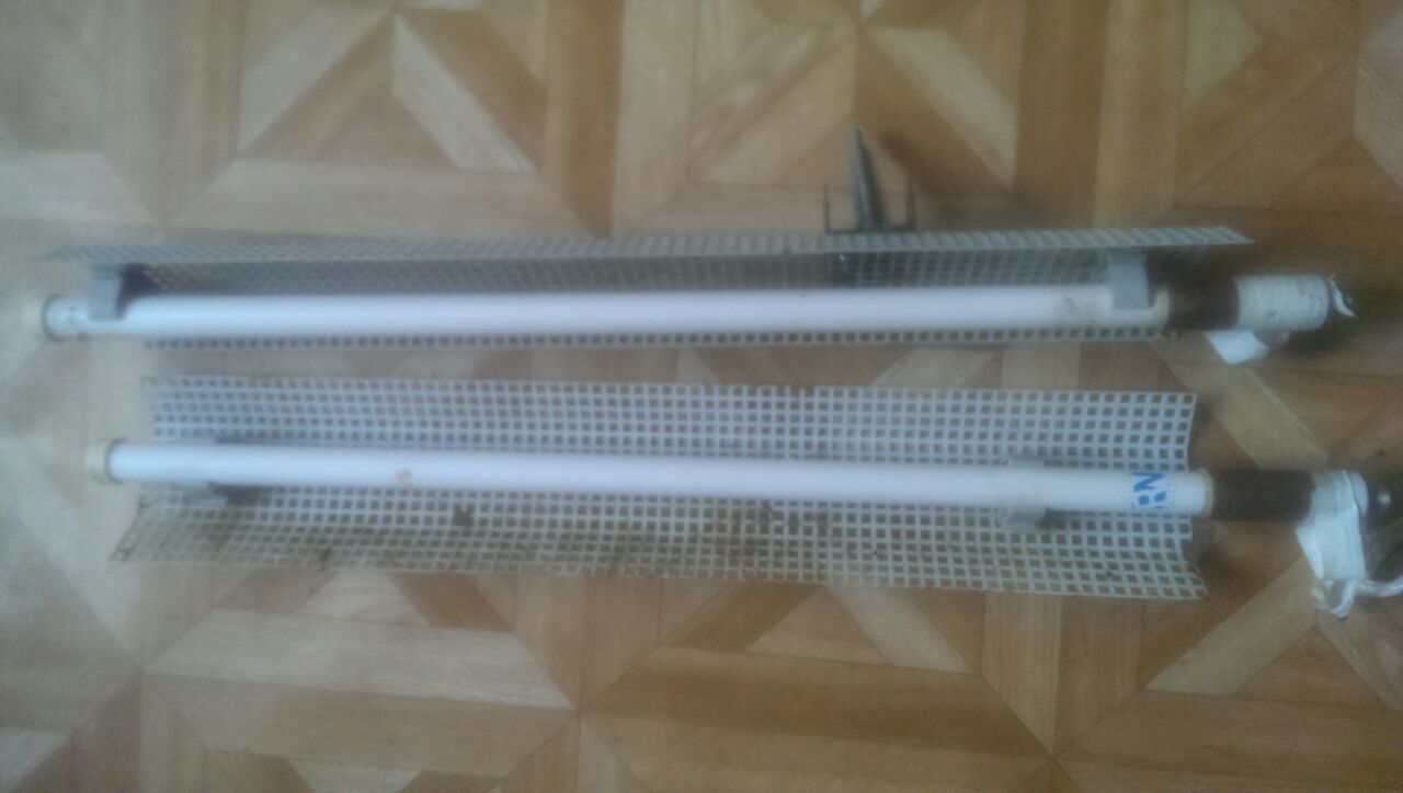

No, I meant the connectors on the Wi-Fi module. The module has three connectors (CH0, CH1, CH2). Is there any difference in which of these connectors to use when connecting two sector antennas, assuming the antennas are SISO (Single Input, Single Output)?

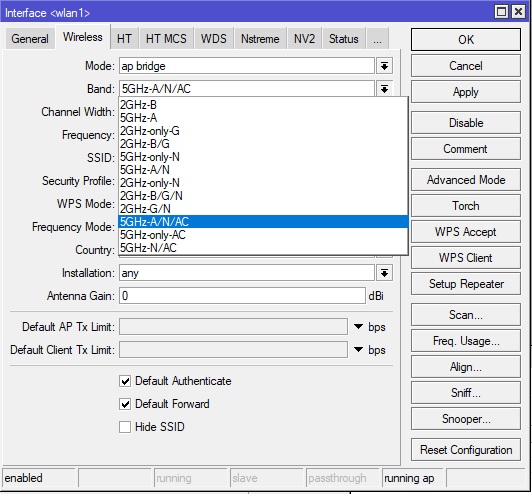

Have you tried working with just one AR98XX module? I purchased one myself, similar to your Compex WLE900VX. I can’t figure out how to configure both the 2.4GHz and 5GHz bands to work on this single module.
In the interface, only one Wi-Fi module is visible. In the wireless settings, there is no option for simultaneous operation of the 2.4GHz and 5GHz bands, and it is unclear if there is a way to configure them together.

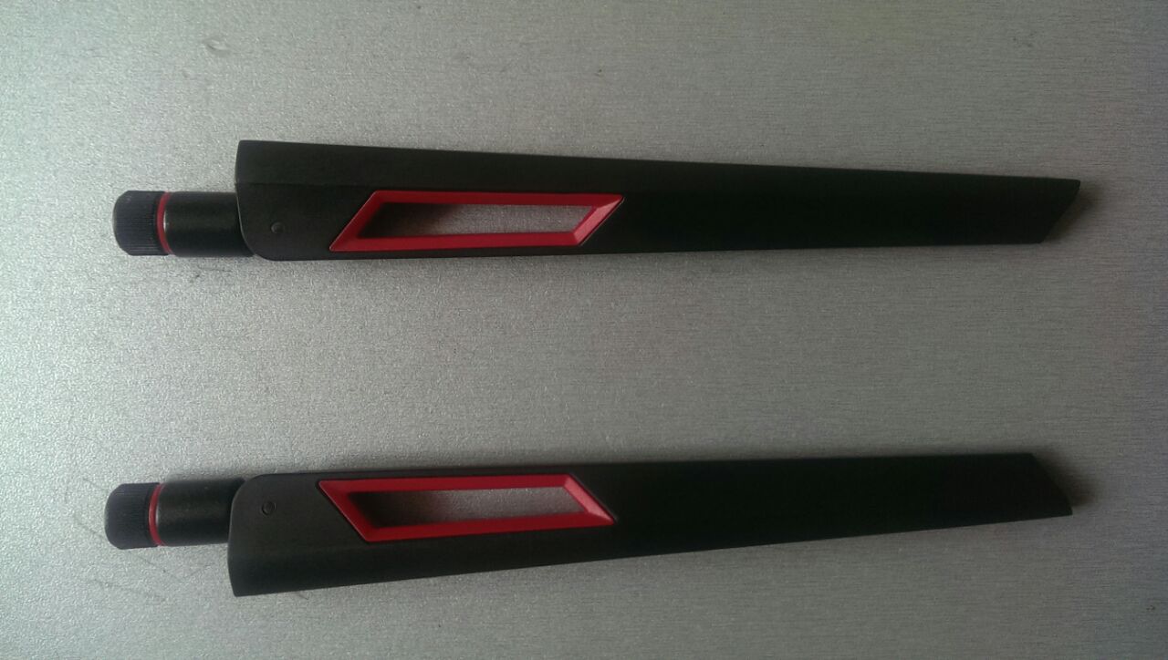

Currently, only two such antennas are connected; the sector antennas haven’t been included yet.

That’s not possible, all supported chipsets can only server single WIFI channel. Yes, the modules supports both 2.4 and 5GHz bands, but there is just one local oscillator that can run on one or the other frequency band, meaning this card can either run as 2.4GHz or 5GHz, but never both at the same time.I know there were some hybrid miniPCIe modules that had double the radio chipsets and parts, but they used completely incompatible chipsets and thus would never not work in ROS.
If you need to create AP with both bands, you have to use multiple radio cards (just like JohnTRIVOLTA shown on his photo), there is no other way around that.
