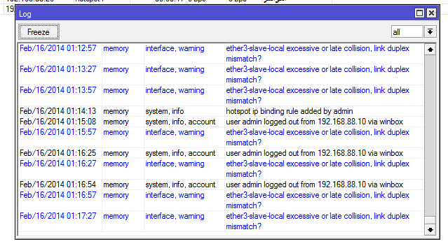

log: excessive or late collision, link duplex mismatch ????
in log keep this come up:
memory interface, warning excessive or late collision, link duplex mismatch
what’s this?
