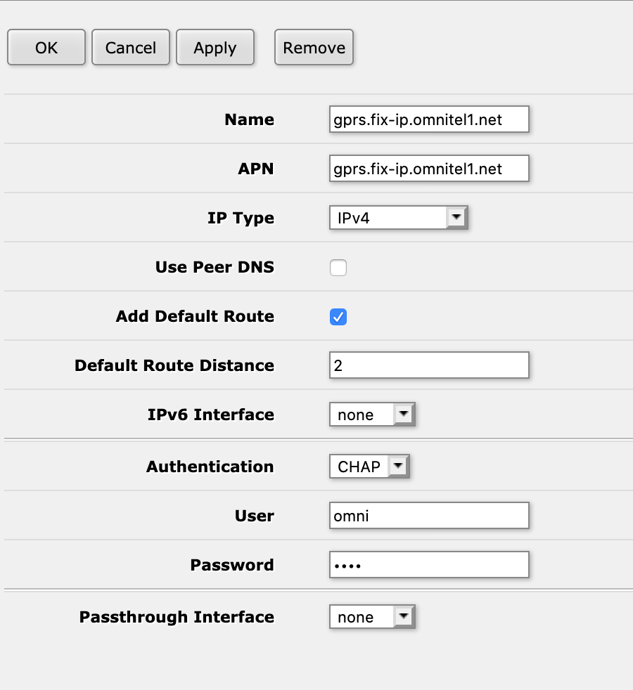

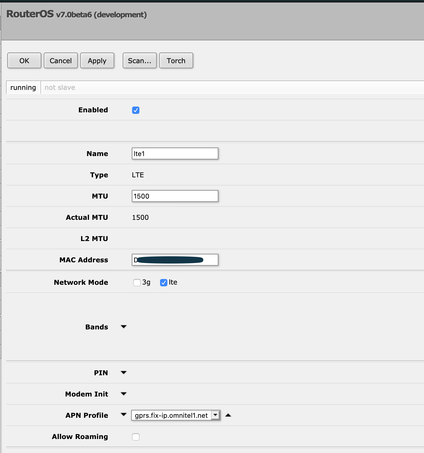

just got my Chateau LTE12 and it came with latest beta preinstalled v7.0beta6. Seems like this release is not in public channels yet, it’s OK but, I have just configured it to use with Telia LT fixed IP APN, and I’am still getting dynamic IP. It works as expected with same SIM and APN config on Huawei router. May be there some known issues with beta release? Should I downgrade to stable instead? Which debug information should I provide?
Thx.

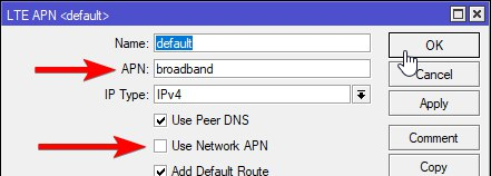

APN in RouterOS 7
or all steps
