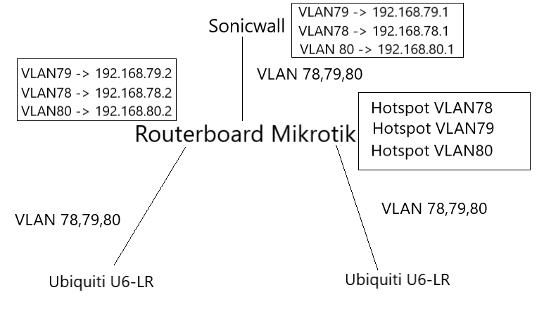

One block diagram can help, but probably the only mac you can see on sonicwall is the routerboard MAC because it act as router…
In fact, exactly the only MAC that Sonicwall sees is that of the routerboard.
The routerboard is configured as a bridge on eth1-eth5 with the 3 VLANs and DHCP server on the various VLANs.
If I set the sonicwall ip (192.168. *. 1) as a gateway in the various VLANs, everything works perfectly and Sonicwall sees the ip / mac of the wireless client (but the hotspot does not work).
If, on the other hand, I set the routerboard IP as gateway (192.168. *. 2), the hotspot works perfectly but does not pass the wireless client’s ip / mac to the Sonicwall.
I also tried with mangle and routing rules for authenticated user (hotspot + ip / mac of the client visible to Sonicwall works all, but only on Windows PCs while the android clients do not browse):
