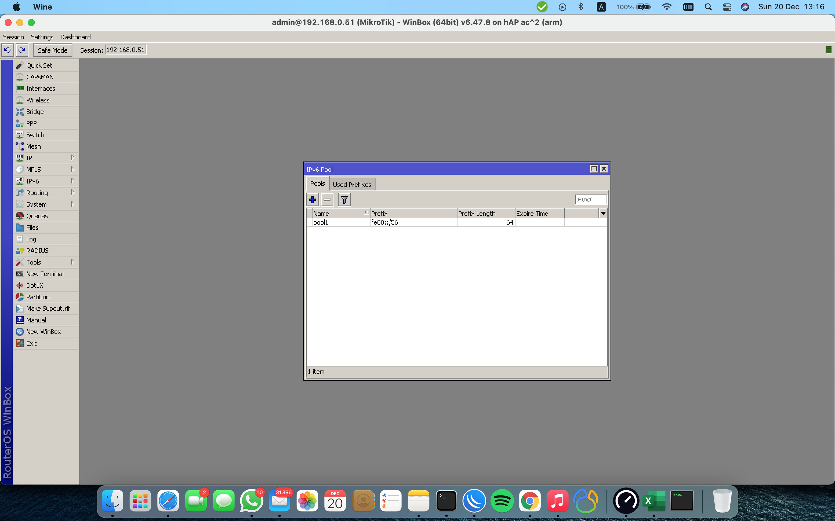

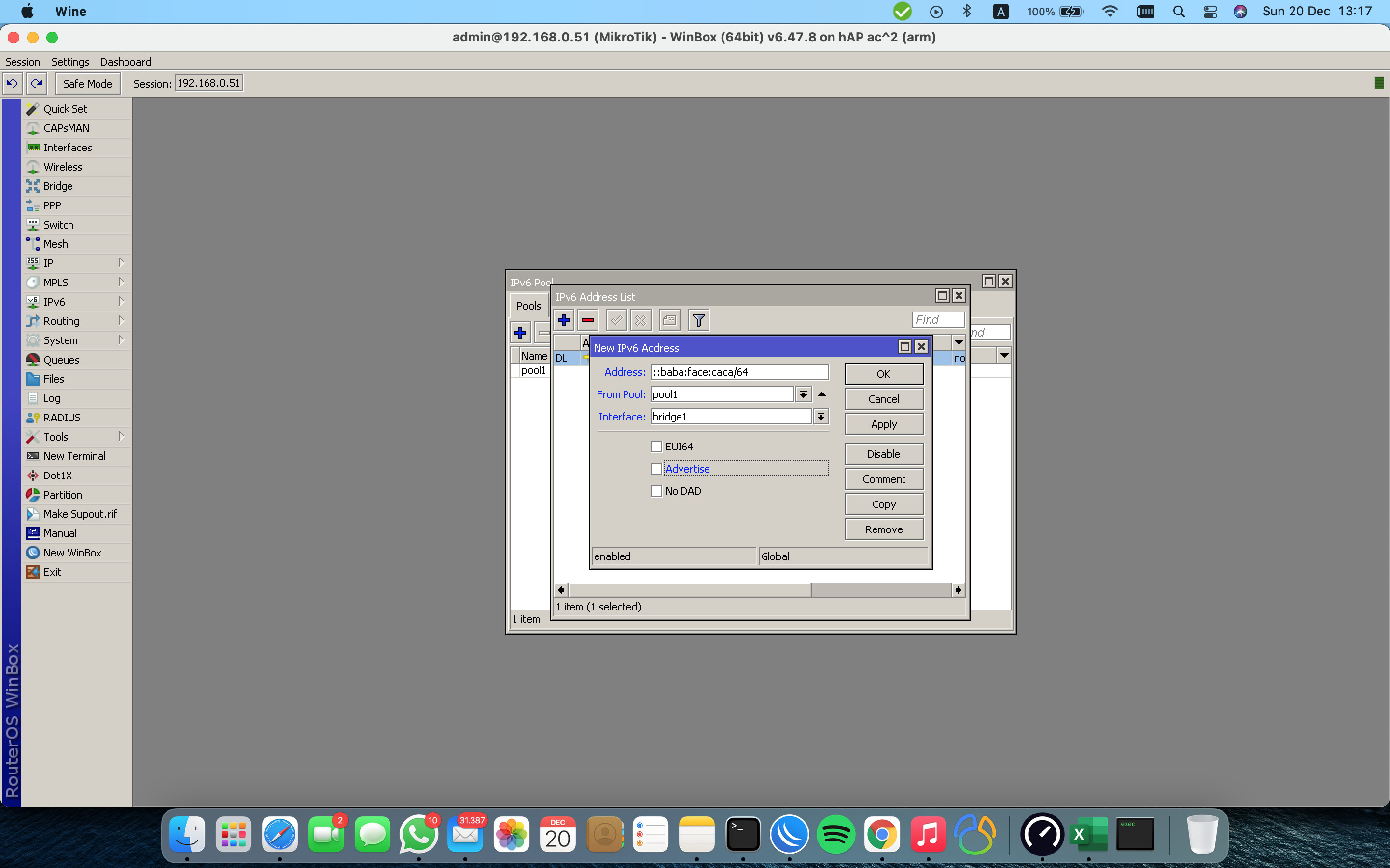

Create an ipv6-pool with fe80 :: / 56 and prefix length 64.
Then add normal ip address only it will be selected from the pool in the form ::aaa:bbb:ccc/64
PS
Uncheck advertise
Attached pictures
Good Luck
Ciprian Arsenie
