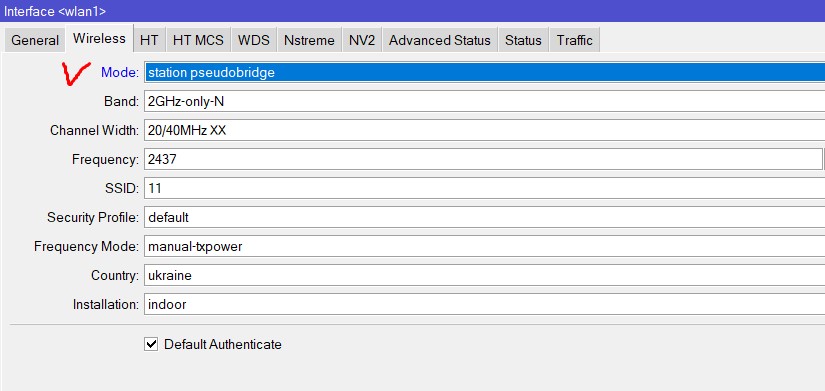

I already had this working in station-pseudobridge mode, but the connection was very unstable and it was interfering with other wifi devices, I presume because my home router ist not a MikroTik device.
