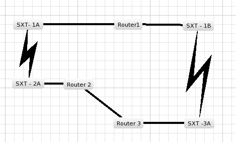

Here are a couple diagrams.
The first image is how I have the network setup right now, router 3 with a portal to the world on router 1/ether4.
The real system will look more like the second image with no ether to all sites
