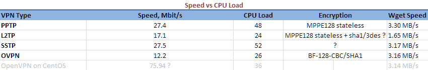

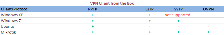

I tried RouterBoard 1200 as VPN Solution for our Office.
Test was produced between RB1200 and Windows7 Ultimate SP1 Pro and Windows XP SP3 Home and Ubunru 9.10.
For speed testing I used iperf and wget:
Server: iperf.exe -s
Client: iperf.exe -c 192.168.0.2 -P 15 -w 10000
wget ftp://test:test@192.168.0.22/routeros-5.8.arc
#2011-11-16 23:01:30 (3.14 MB/s) - `routeros-5.8.arc' saved [81351895]

Attached RB1200-As-VPN-Solution.xlsx
RB1200-As-VPN-Solution.xlsx (11 KB)
Thaank you very much for your work. I really expected to see higher numbers on the RB1200. I still have some Cisco 3000 VPN concentrators working which I wanted to replace. But I definitely need more throughput. Looking at Mikrotik´s support for SSTP, I reaaly considered those. Well, it would be interesting to see what VPN throughput the RB1100AHx2 will have.
An alternate solution would be to use Windows Server 2008 R2 (enterprise) on a 1HE Intel Xeon E3-1230 based server, where one could use PPtP, SSTP and L2TP/IPSec (with e.g. certificate based authentication).
I have several questions:
  1. do you run tests from and to the router or through the router? - it must be through
  2. Do you single or multiple simultaneous TCP connections? - it must be multiple TCP or UDP, to avoid protocol limitation.
  3. Are you sure there are no MTU (MSS) problems with setups?
RB1200 as VPN solution. I tested it as VPN Server.
Speed test was performed through VPN on RB1200.
Client — Internet ---- RB1200 ---- LAN ---- Server
  1. Do you single or multiple simultaneous TCP connections? - it must be multiple TCP or UDP, to avoid protocol limitation.
As described in the first post i used iperf:
-P, --parallel # number of parallel client threads to run
In my case P=15.
