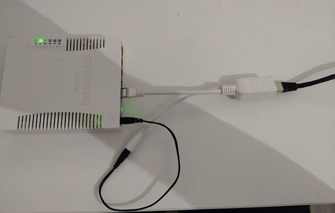

Soo i used it in the past as a PoE-Splitter, and it worked !
Tried it again today… still works =)
** I don’t know why mikrotik doesn’t advertise it as a Splitter!
Maybe it is missing some voltage protection circuit or something…
Yes, it will work perfectly fine. It’s just a passive device and 100% bi-directional. Injector and splitter for passive POE is exactly the same inside, only difference is in the connectors…
