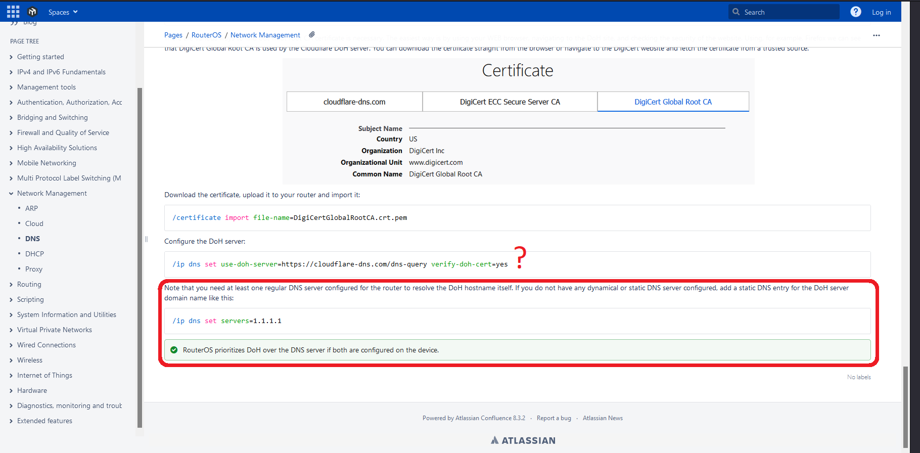

dude should I enable normal DNS when using DoH ? Becuase in most of my researches they recommended me to “disable and remove ip v4 and ip v6 DNS in order to be able to use DoH” on mikrotik devices but this mikrotik manual tells me otherwise ? I actually did it and got no feedback other than normal DNS is being used becuase of the lack of DoH … I’m so confused :frowning:
