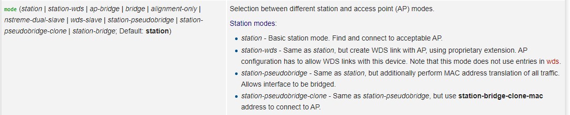

(Try to find the information for mode “station-bridge” …and “mode” information is not yet transferred to the ‘help’ reincarnation)

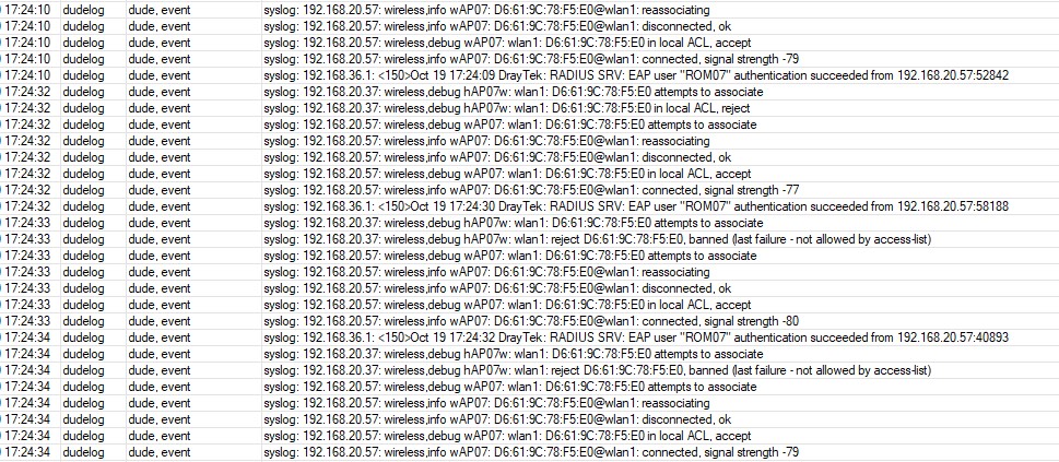

But where is the “message manual” so we can understand the informative debug messages?
Accept/reject OK. But what is “banned (last failure - not allowed by access-list)”. Comes after repeated rejects?
Or is this indeed the “Allow signal out of range” time for the reject rule ???
(2 AP’s for roaming hAP07w and wAP07. Elapsed time 3 sec)
Well this might be an excellent idea. After 24 hours, with a much lower (3 sec) out of range time in the reject rule , I had no more “banned (last failure - not allowed by access-list)” messages !!!
So far the long out of range time in the reject rule seems to have triggered that banned condition.
Current setting: "Allow signal out of range " time for the authenticate rule (120..-86) is 30 sec, and 3 sec for the no-authenticate rule (-87..-120)
