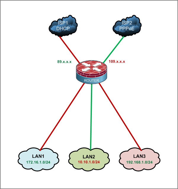

I have PCC setup, one router, two ISP, and three LAN.
The questions are:
  1. Is it possible to connect from internet to both static IP addresses, becouse i can’t connect to PPPoE IP of the router?
  2. How to setup LAN1 and LAN3 to go via ISP1 to the internet, and LAN2 to go thru ISP2?
  3. How to configure failover for LAN1?
The diagram:
  1. If you had PCC based on example config (https://wiki.mikrotik.com/wiki/Manual:PCC), then connecting to both public addresses would already work. Check that page. First you mark incoming connections in prerouting, based on WAN interface. Then you mark routing for responses in output, based on connection marks.
  2. One way is something like:
/ip firewall mangle
add chain=prerouting src-address=172.16.1.0/24 connection-mark=no-mark dst-address-type=!local action=mark-connection new-connection-mark=ISP1_conn
add chain=prerouting src-address=10.10.1.0/24 connection-mark=no-mark dst-address-type=!local action=mark-connection new-connection-mark=ISP1_conn
add chain=prerouting src-address=192.168.1.0/24 connection-mark=no-mark dst-address-type=!local action=mark-connection new-connection-mark=ISP2_conn
  1. There are different methods. You can just add ISP2 gateway to ISP1 routing table with higher distance and check-gateway option for both, or you can try something more complex like Advanced Routing Failover without Scripting.
The “Advanced Routing Failover without Scripting” is even better. That is actually what I need.
I just need 3 LAN to have 2 ISP with failover, 2 of LAN to go thru 1st ISP and third LAN to go thru 2nd ISP, no load balancing is actually needed.
Can you please post the complete configuration, based on the setup from my diagram?
