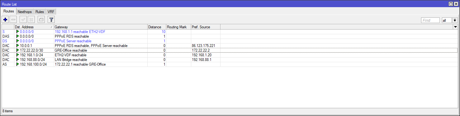

The routes are mostly dynamic besides 2 that are for my fail over connection and GRE Tunnel.
add distance=10 gateway=192.168.1.1
add distance=1 dst-address=192.168.100.0/24 gateway=172.22.22.1
A photo of the routes can be seen in the attachment.
