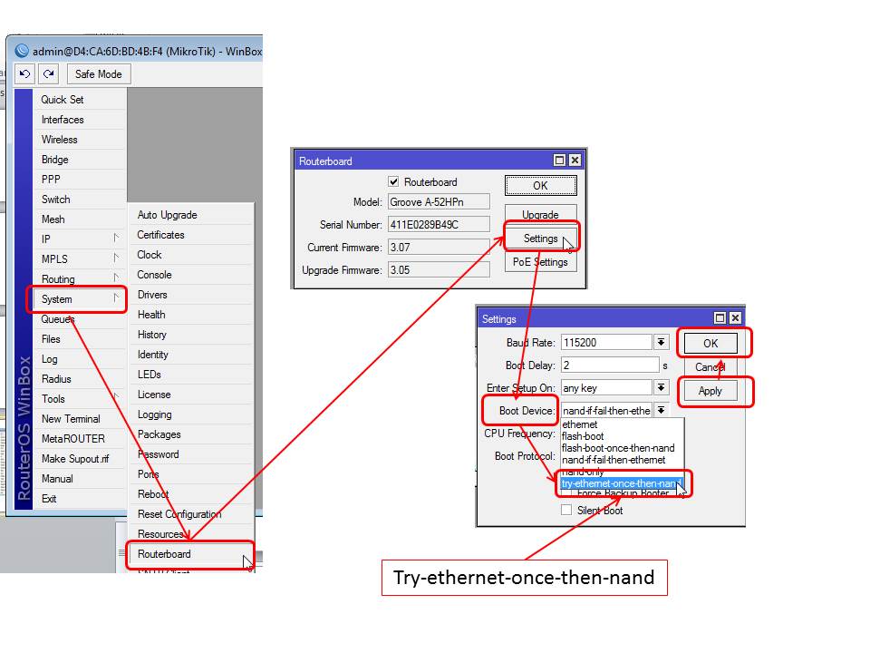

OK guys, thanks for at least trying to help me - I have just managed to get this sorted OK now.
Some initial comments
  1. I don’t have to run as Administrator in Windows7
  2. I can have my antivirus running (did try without)
  3. Other programs can be running too
This is what I did:
  • prior I was getting Netinstall to see the Groove by holding the reset button down - not any more.
  • NOW, instead I first access via WinBox, go to System > Routerboard > Settings >Boot Device and set this to “try-ethernet-once-then-nand”
  • then Apply and OK (see attachment)
  • close WinBox
  • power down the router.
  • open Netinstall - v6.1 in this (I will try v6.3 next)
  • power router (not touching the reset button at all)
  • router appears in Netinstall OK
  • do the Configuration script load, RouterOS and the NTP package (I need) all in one hit - and install
  • router installs then automatically reboots.
  • upon reboot System > Routerboard > Settings >Boot Device is reset to “nand-if-fail-the-ethernet”, so no need to change it.
and away you go…
No issue - all of my Grooves are now set up…now to see if this will make my Kernel failures stop.
Hope this helps someone out in the future - maybe I should update the Wiki?
