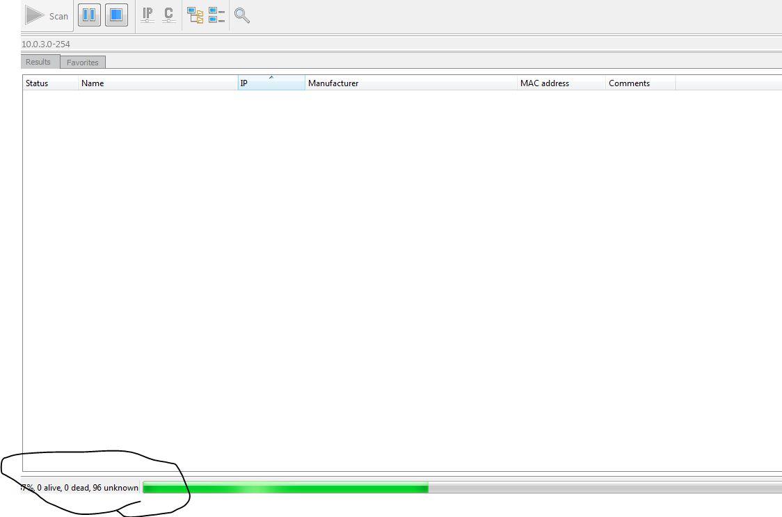

UPDATE :
after further testing
this method is not working at the blocking part but the scanner detect is very accurate i think these apps use ip or arp dhcp protocol and i will test bridge firewall to block the scan will update soon
any help in the blocking part join in
Any testers? Share results.
NOT working in blocking part but the local to local scan detect is very accurate

Hello, Please I am in same situation . A lot of problems to block soft such as Angry ip scan, Advanced ip scan. Please Help.
