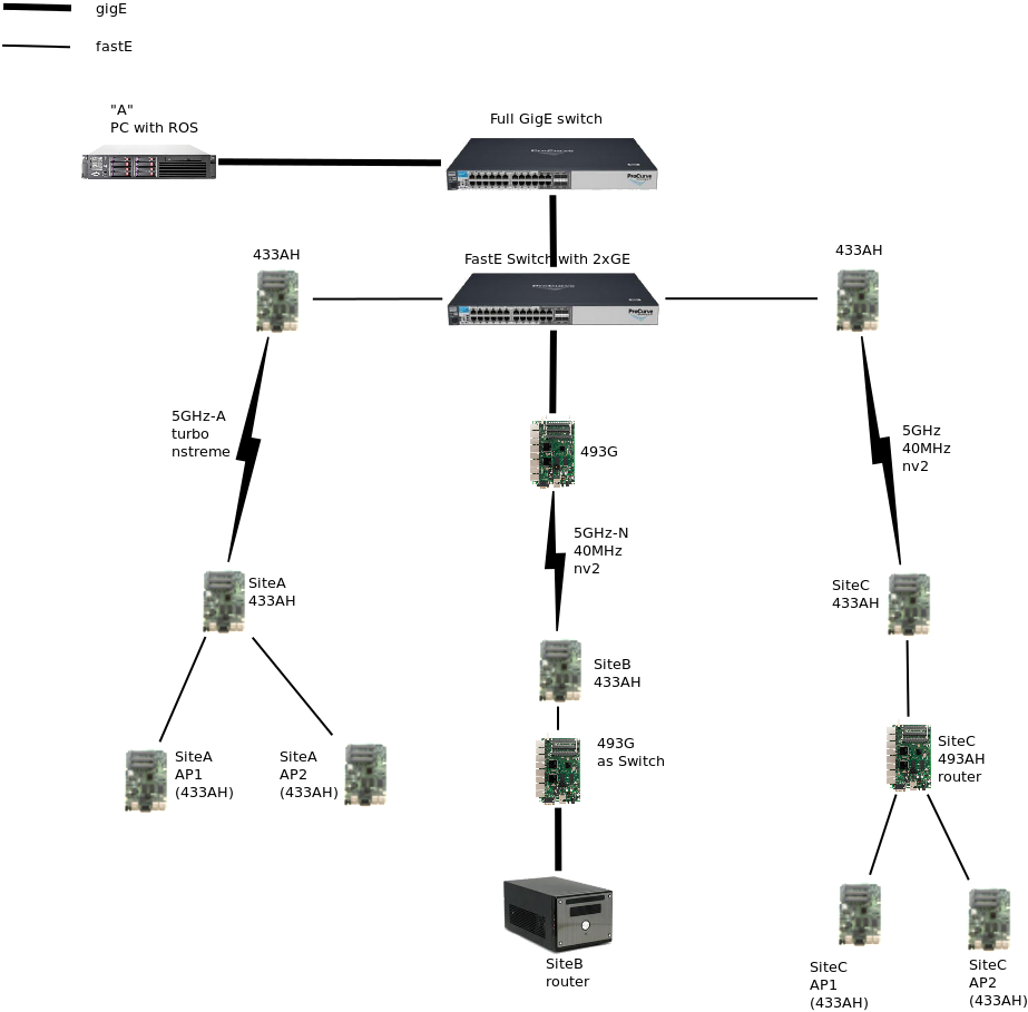

As seen in the structure above, the measurements happens with btest to/from point “A” on top left. It’s connected to a full GigE switch,
what’s connected to a 24x100 and 2xGE switch with GE uplink. Measurement done with TCP.
the 433AHs connected to FE port, while 493G connects to a GigE port (ok, thru a RB2011’s GigE port - but everything is full gig in this line).
What is found is:
  • From “A” to SiteB router (what’s an atom PC) can happily do HDX 150mbps (90+60mbps since the remote radio is in a 433AH as visible)
    before the 493G, the local radio was in 433AH as well. Speed was ~40M down and 80M up (but with bad direction)
  • From “A” to SiteA AP1 and AP2 i can measure ~ HDX 80mbps (split by the two receiver, since ~60mbps eat’s up a 433AH’s CPU)
    as i know, ~ 80mbps is the limit of single polarity nstreme link
  • From “A” to SiteC AP1 and AP2 i can push ~60mbps down and ~80-90mbps up (also in bad direction)
    (hopefully today the 433AH feeding SiteC will be replaced to RB600 with GE uplink - fingers crossed)
    I also can measure higher speed from a 433AH connected to a switch than from “A” PC.
