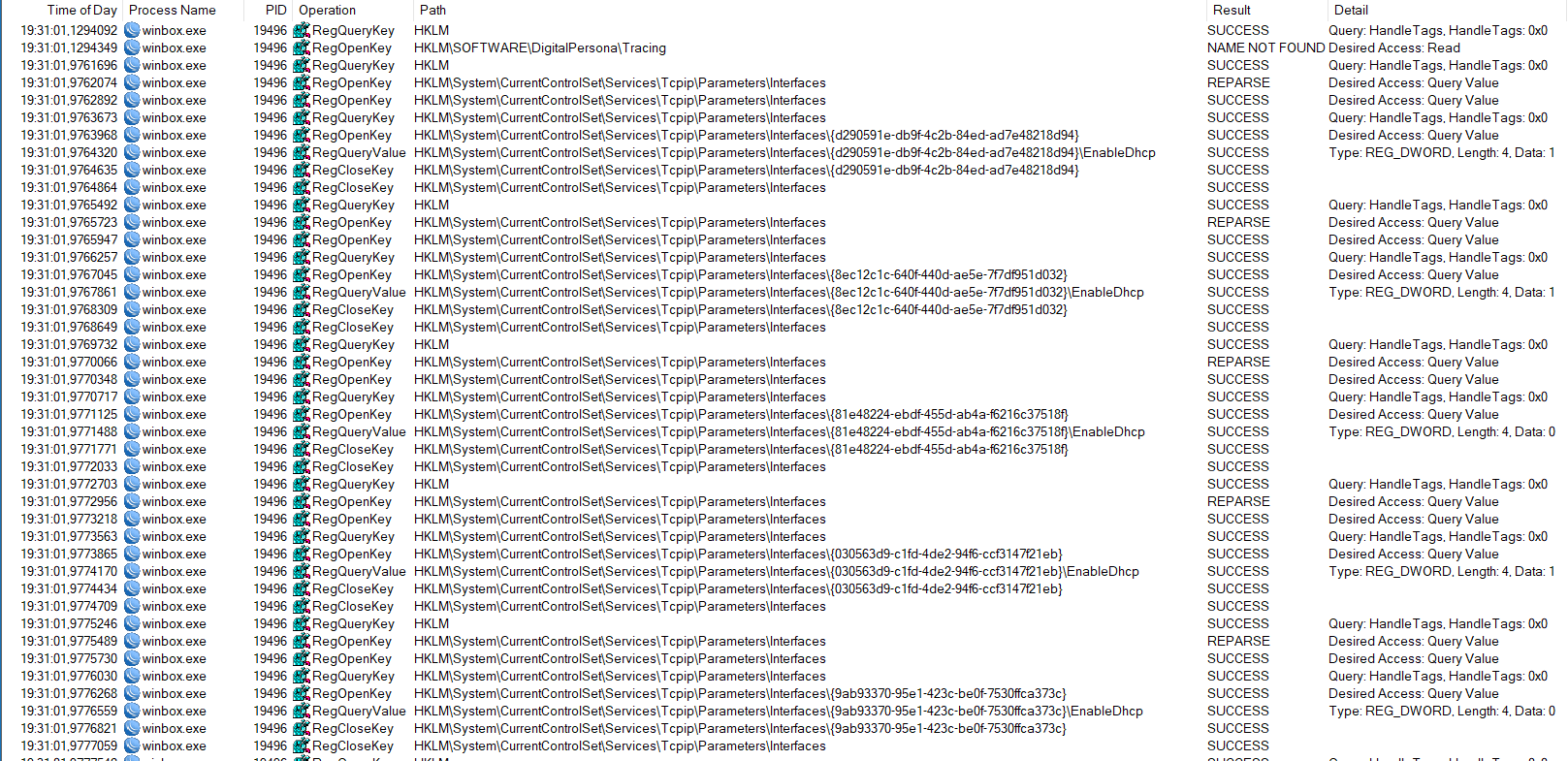

  3. Using Process Monitor I could observe that Winbox enumerates all network interfaces at any time when it is important to know which NIC to use: namely, at least when IP neighbors are refreshed and when a MAC telnet connection is attempted. This is confirmed in the following screenshot:
    This means that Winbox does a good job at attempting to detect all applicable network interfaces and picking the correct one whenever needed.

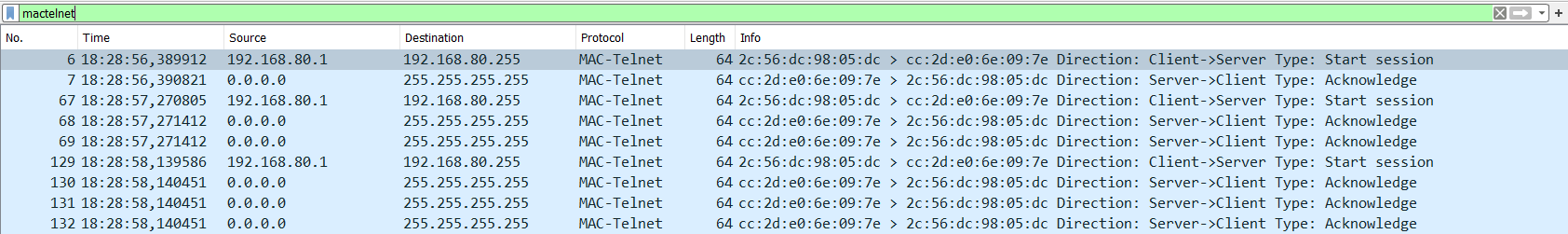

  4. On the failing host, I have used Wireshark to inspect network traffic on the NIC where I expected to see MAC telnet packets, and that traffic was indeed there:
    So, the issue is not with Winbox picking the wrong network interface.

  • MAC telnet uses UDP, which is a connection-less protocol, as its transport layer. Therefore, to establish a “telnet-like” session based on UDP, the connection-wise semantic must be reimplemented from scratch. For the case of MAC telnet this means that Winbox first emits a UDP packet from a random port number P targeting a broadcast IP address and the standard MAC telnet port (20561). Immediately after, Winbox listens on UDP port P for replies to this packets that confirm session establishment with the router. The fact that Winbox temporarily listens to this random port P is clearly visible by using utilities like Process Explorer or TCPView. The time for which Winbox listens on this port is quite short, but should be enough for the router to reply. In any case, multiple attempts are made (by Winbox to start the session and by the router to send acknowledgments) before giving up, so that Winbox always has enough chances to establish the session.
  • On my host where MAC telnet fails, Wireshark and Process Monitor confirm that UDP packets are indeed emitted and the router replies, sending its packets from

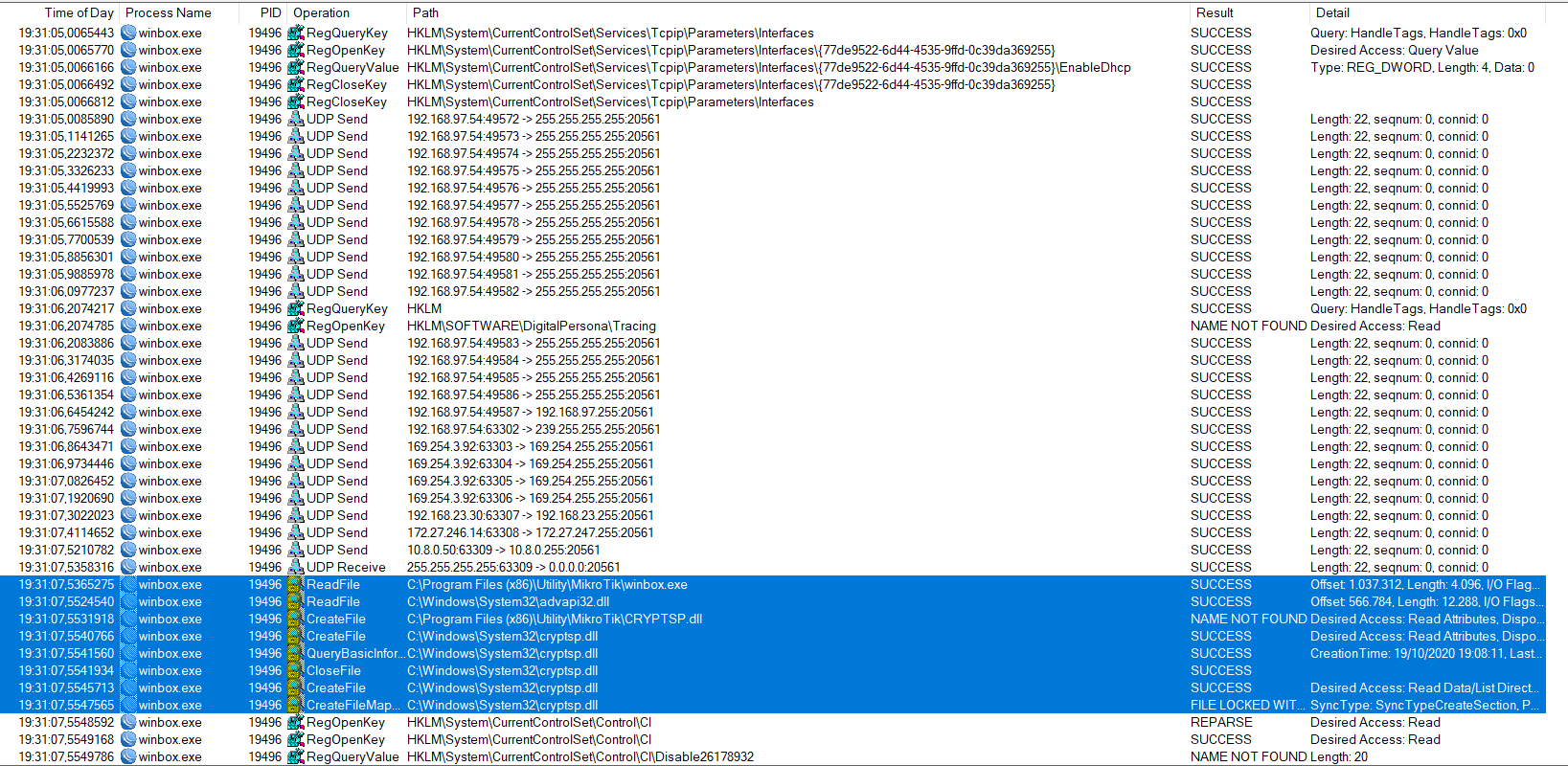

  • Further investigation by using Process Monitor during a MAC telnet attempt revealed an important behavioral difference between the working host and the failing one. Soon after UDP packets are emitted by the working host, Winbox looks for standard system-wide cryptographic libraries in order to prepare session establishment:
    This behavior is not observed on the failing host, where “UDP Send” events are just followed by… nothing (possibly just some late “UDP Receives” which are not processed anyway).

  • Winbox not attemping to find system-wide cryptographic libraries (they are not missing: it’s just that Winbox never reaches a phase when it needs to look for them)
  • Some software layer preventing Winbox from being able to process MAC telnet acknowledgments sent back by the router (which are actually received by the host, as confirmed by Wireshark)
