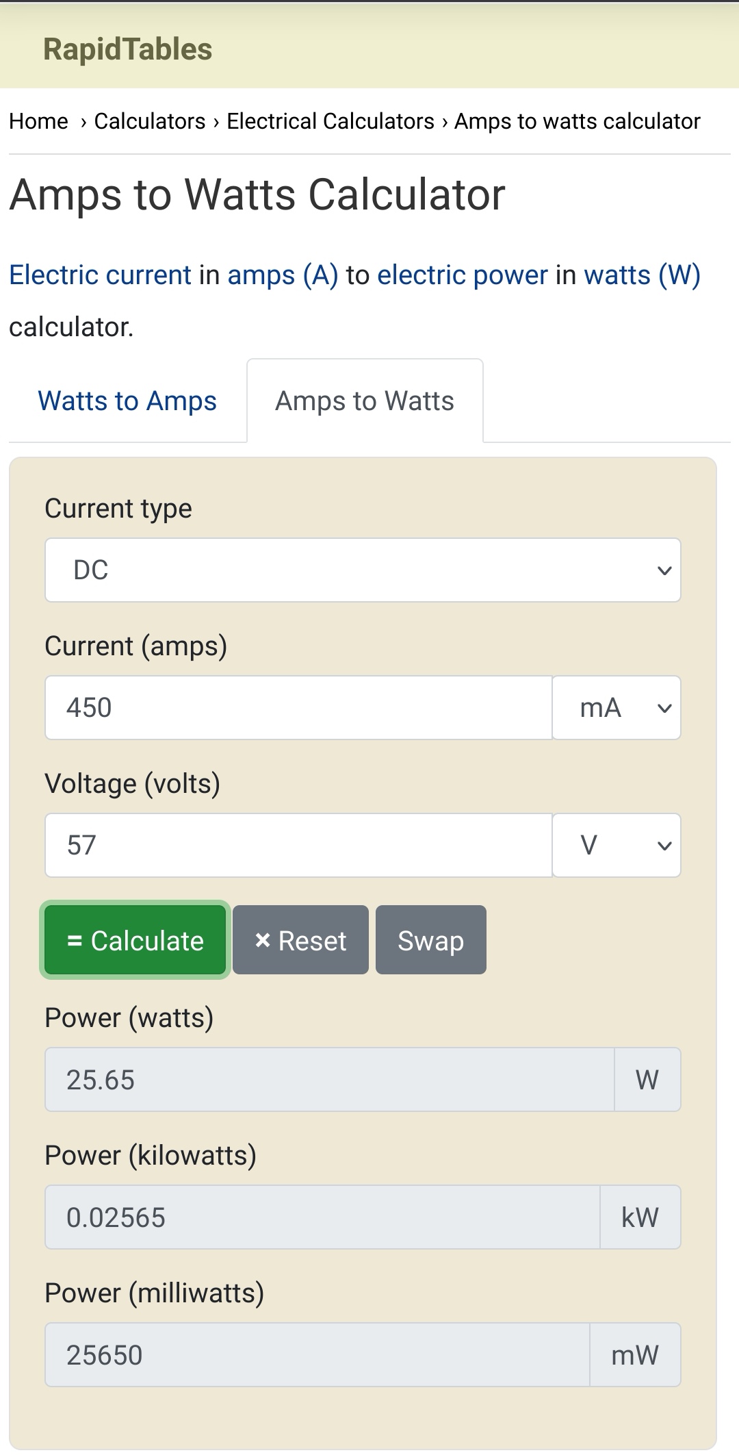

For easy math you can use this: https://www.rapidtables.com/calc/electric/Amp_to_Watt_Calculator.html

BTW, at standard allows max 57V. If one manages to get hold of 57V power adapter for MT and considering 450mA limit, this translates to 25.65W … which is only so slightly above minimum required power at PD for at (25.5W). So with a short cable and when using 57V power adapter, Mikrotiks can qualify as supporting at. OTOH at standard requires PSE output voltage between 50V and 57V which is not possible achieve when using power adapters sold by Mikrotik (nothing above 48V).

Yes, the PD is drawing around max 530 mA at 48V, which translates to a power consumption of 25.4 watts. If I used a 57V power supply, then at 450mA I could provide 25.7 watts of power, which most of the time would be sufficient. However, the PD specs state a potential maximum consumption of 33 watts. I haven’t observed this much power consumption but it’s possible according to the PD manufacturer. Unfortunately, the CRS112-8P-4S-IN is inadequate even with a 57V power supply as that would only provide 25.7 watts max.
