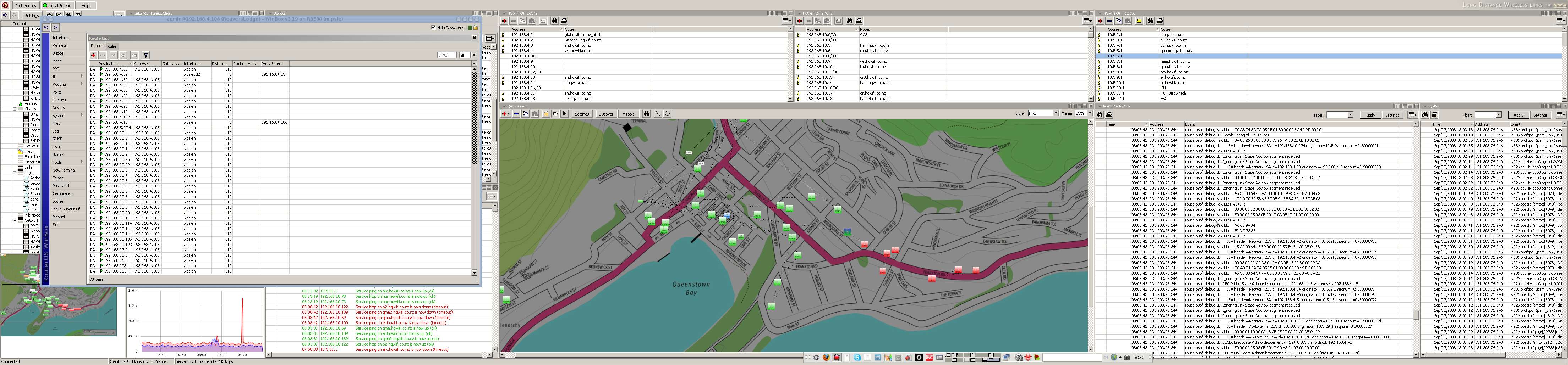

I’m having issues, not related to MD5, but routes keep appearing and dropping, OSPF adds the hotspot interface as Priority 1, Cost 10 Default gateway, although traffic doesn’t go out that way, I don’t need OSPF on that interface, so I setup Hotspot manually as Priority 0 DROTHER.
However, I can’t find why my routes keep dropping and restarting. Everything was setup and operating on 2.9.38, upgrade to 3.19 has broken it.
Setup.
AP0 - WDS - AP1
AP1- WDS - AP0
AP2 - WDS - AP1
AP2 - WDS - AP0
OSPF
2.4Ghz Links Cost 55, Priority 1, MD5, Broadcast
5.8Ghz Links, Cost 10, Priority 1, MD5, Broadcast
Uplinks, Ethernet, Cost 1, Priority 1, Static
No RIP, BGP or other Interior Routing Protocols.
Routes will drop from approx 80 Routes, down to 30 (down to 17 if I remove the Static Routes that are keeping us alive)
Any help appreciated. I’m going to try and replicate the issue in my testing network.
At the moment my Testing network is all Dynamic OSPF and seems to work ok. But that’s 3 nodes vs 50 in this ospf cloud.
Thanks!!
